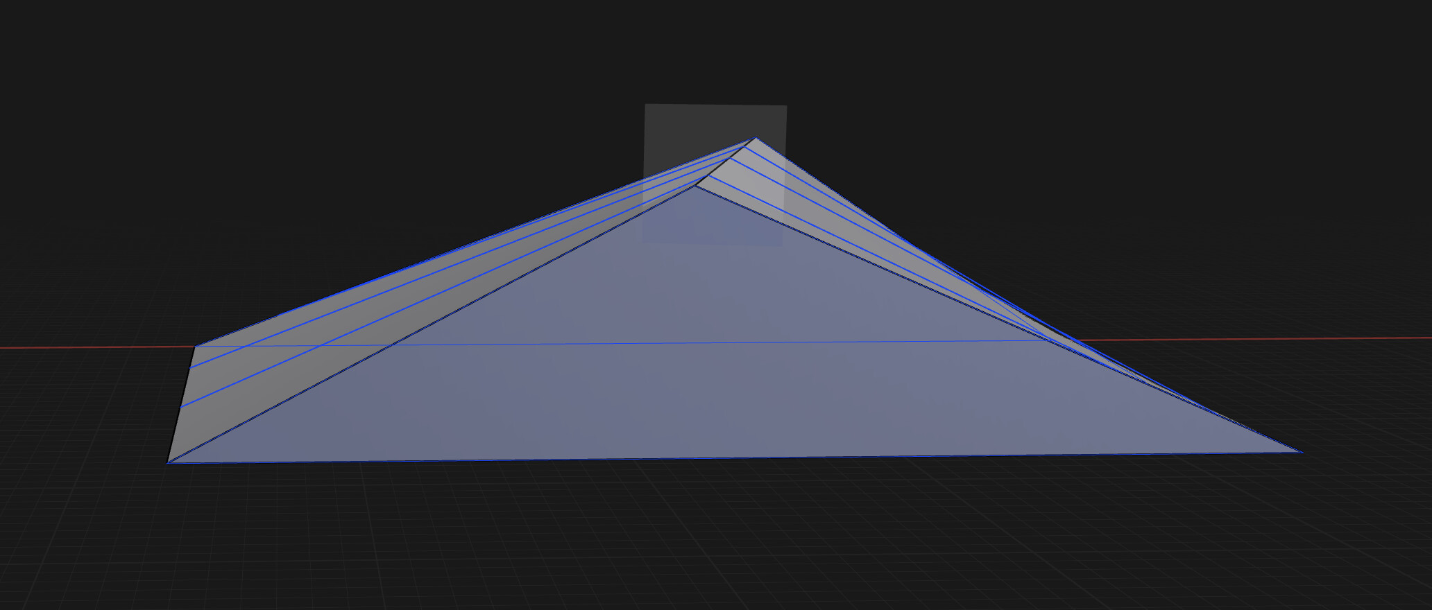

I see the issue, you can’t get the measurement because if it’s a roof your roof is warped so even if you can manually get the angle it will be all different based on where you get it from. I’m working on a house so that the comparison I think of.
More extreme example, I used the Perpendicular Edge Plane to draw the angle, since it’s warped angles are all different.
In my case the surface is not warped but the planes don’t have parallel edges. Thanks for letting me know about creating a plane(perpendicular to edge) to draw onto so that I could measure the edge manually. This is exactly what I needed to know.
