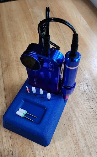

My wife-like creature decided to start doing her own nails. Asked me to make a holder for her device.
2hrs of designing and 8 hrs printing. I used the 0.2mm noise feature in the slicer for the outer skin. Looks cool but it will be a dust collector and adds about 30 minutes to the print. Next time I will leave it a 0.1mm and see what happens.
I used the ironing feature on the very top surfaces. Works okay, added 15 minutes to the print.

Nice. Layer height 0.2mm? What filament did you use?
I used speed .2 setting and Polymaker PLA Pro. Nice stuff. Have to have care with the cardboard reels.
