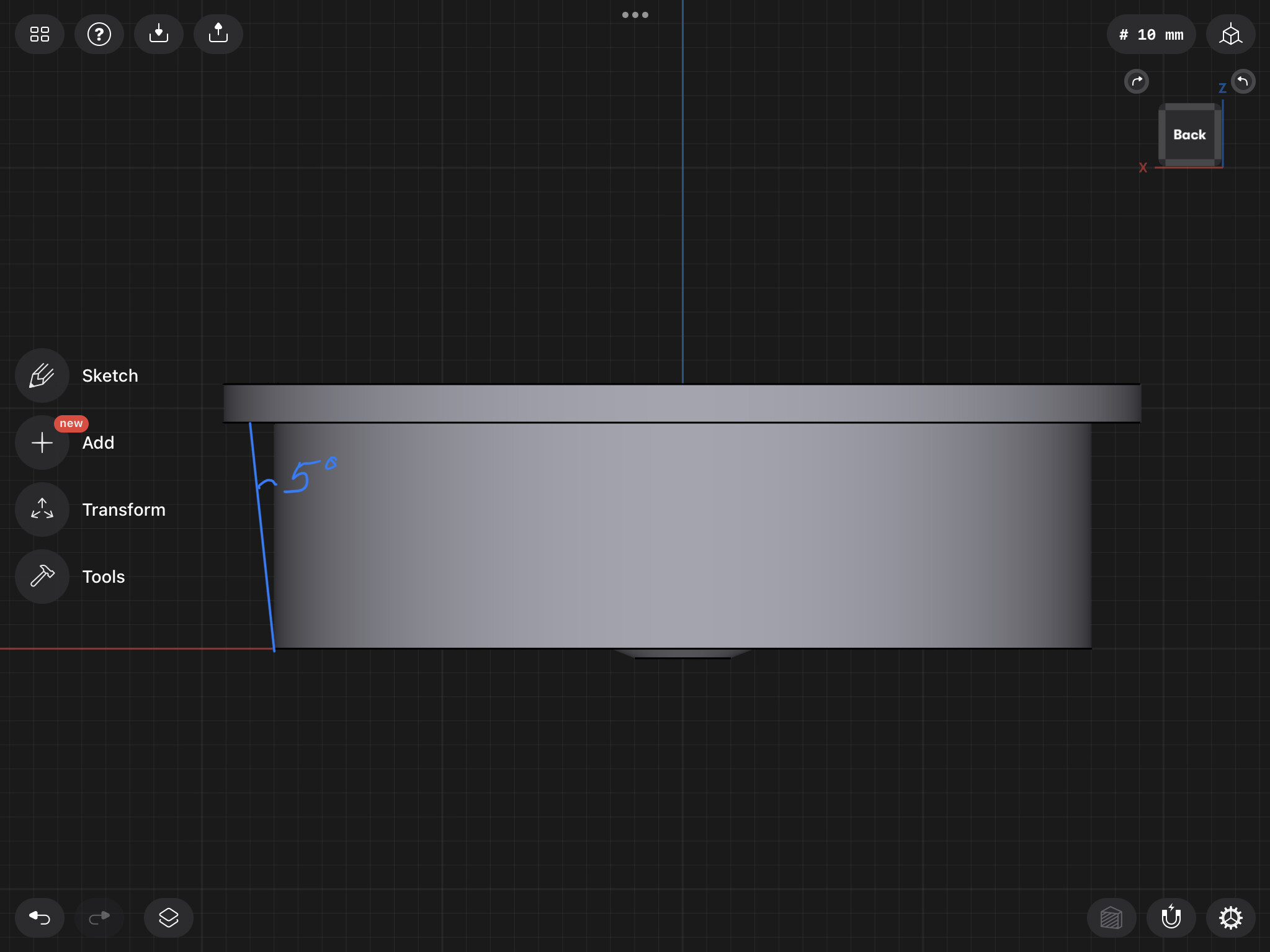

Following is a circular utensil which needs to be given a taper of 5 degrees. How to do so?
The simplest way is to start over and reconstruct the body. Extrude with 5° taper then add the upper rim. Let us know if you need another method. There are many.

This is an example of pattern and die and as in case of finished product as you suggested I would again have to start from initial state.
Currently, we can give draft to a body with square geometry but not the circular .
But in case of a complex body it is not possible to rebuild from scratch.
What to do in that case ?
