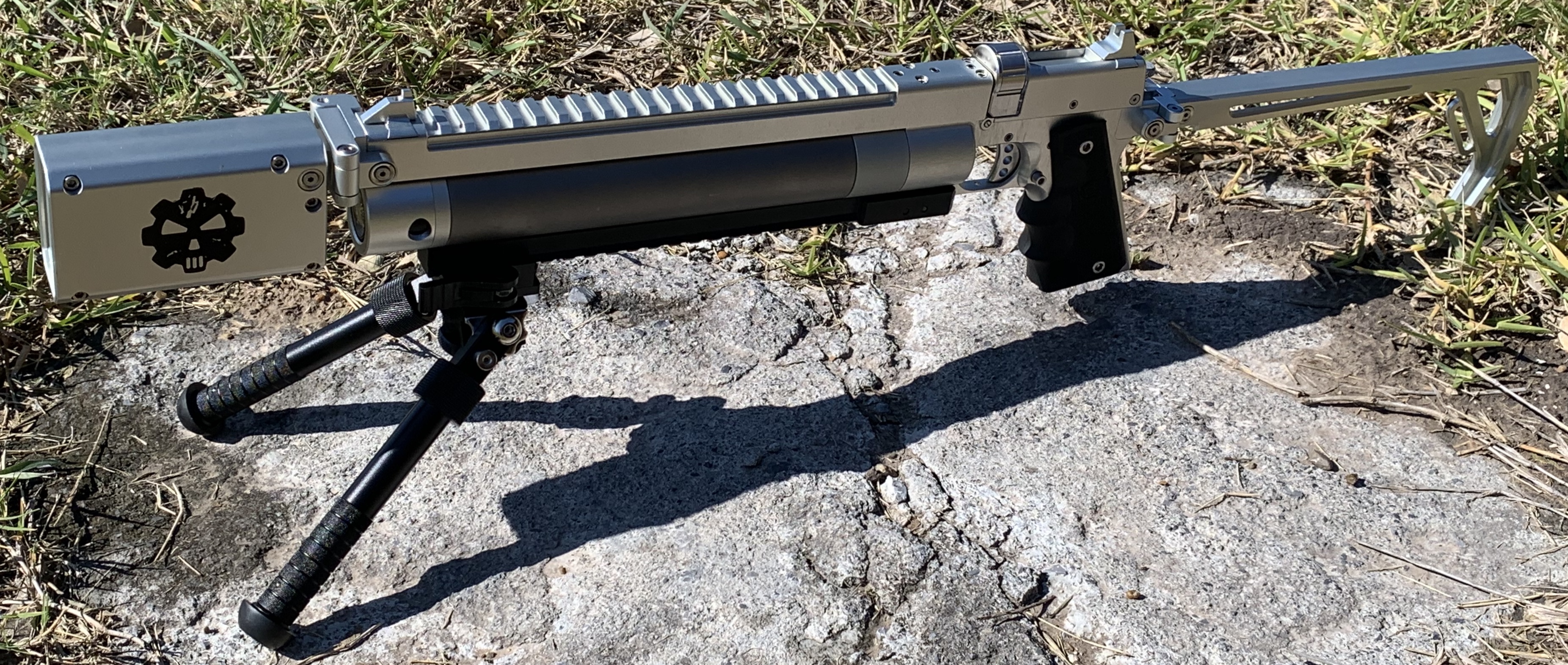

The finished product
Designed and developed only using a IPad.
Impressive! Definitely an advance over a Red Ryder…
