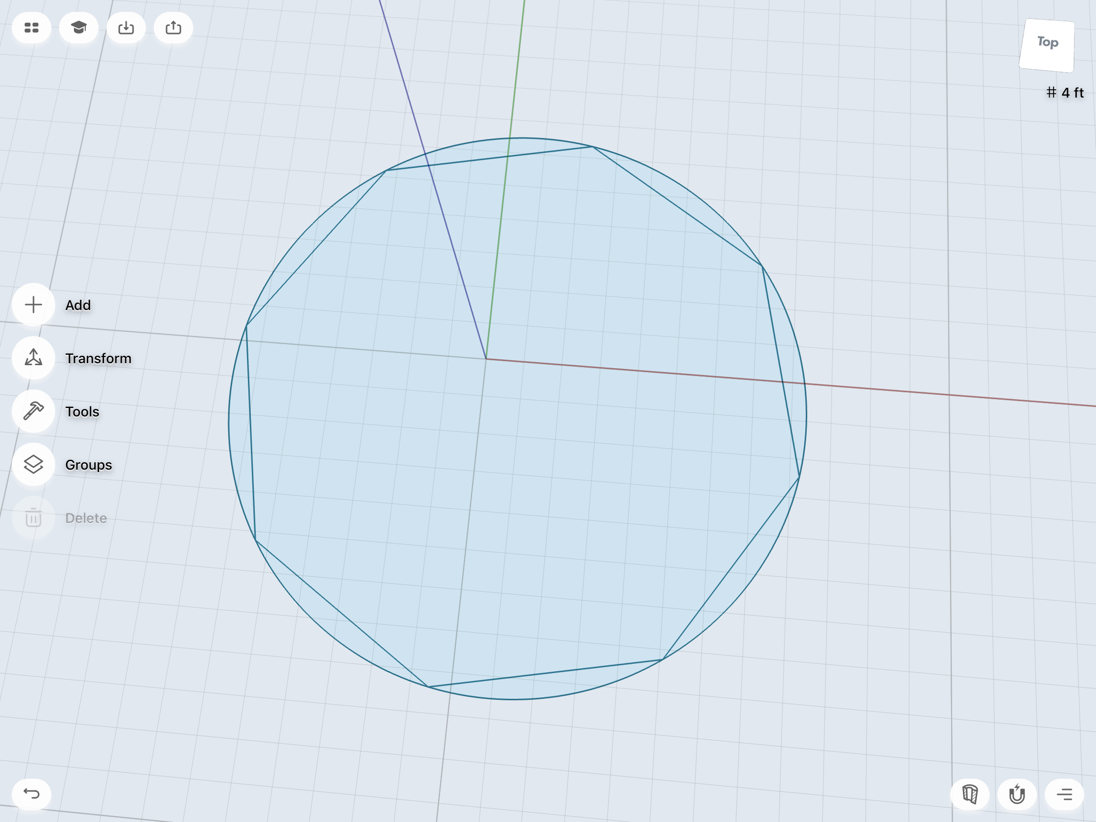

To draw an octagonal shape, just draw a circle in the Top view and inside it draw 8 connected lines. Select all the lines and click the = icon.

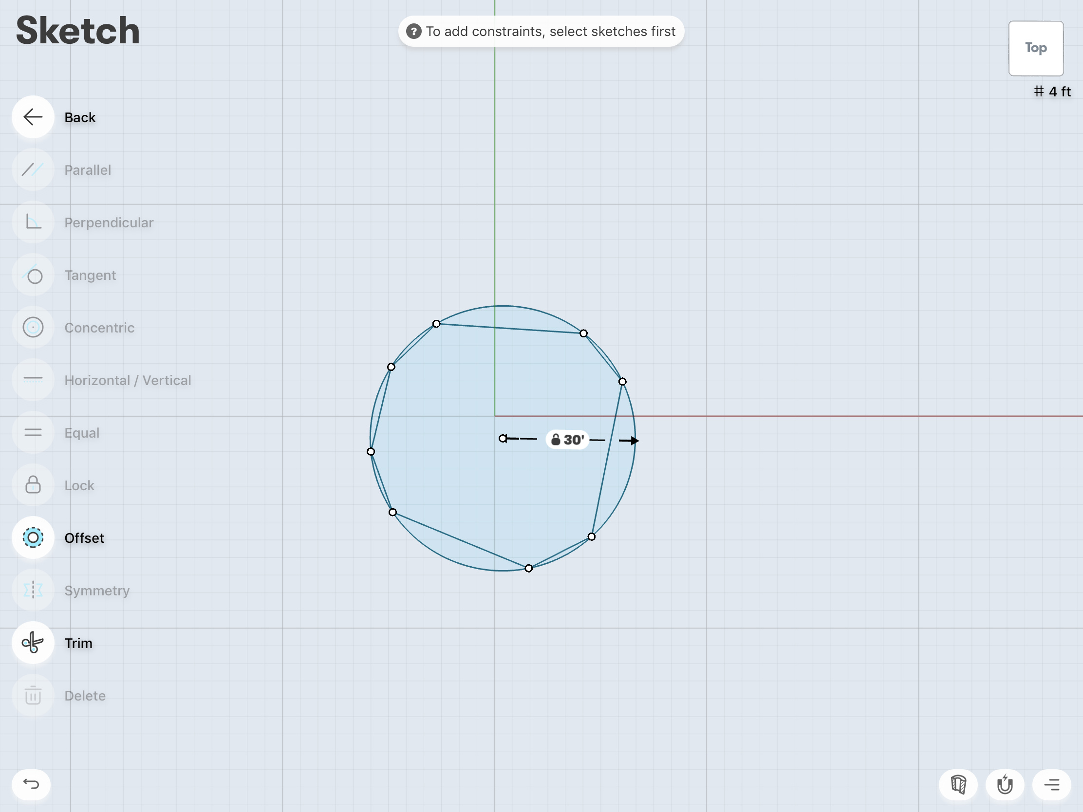

B77A3844-89BC-4DEE-A09B-608B37E3249B378D6F2C-B00C-4C12-882C-9774916BF78E

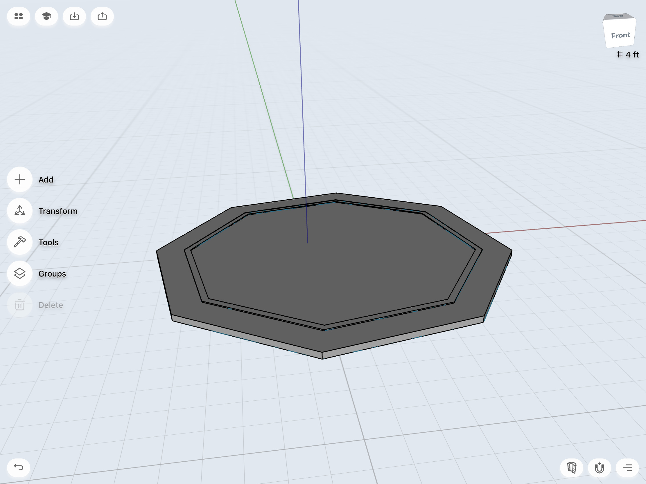

Trim the circle parts away and you have your slab foundation. Use the Offset tool for interior octagonal elements.
