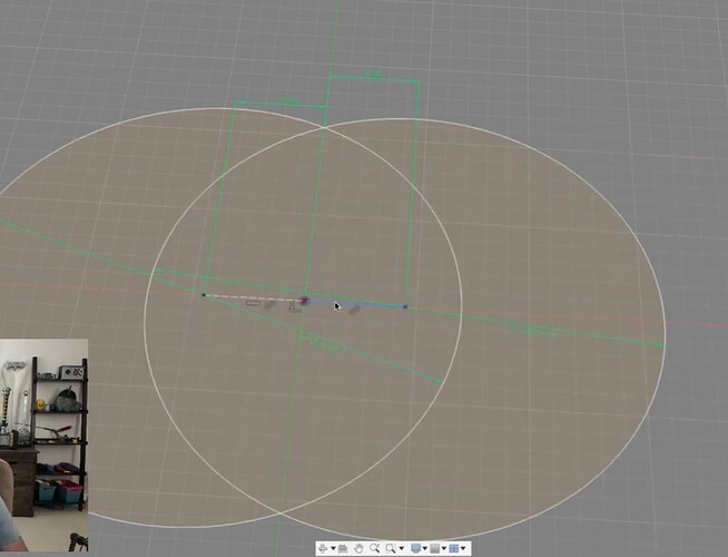

basically it’s two circles overlapping like this and the twisted together.
I think this method can be utilized.

This is so generous of you to take the time to show me how to do this. Thank you!

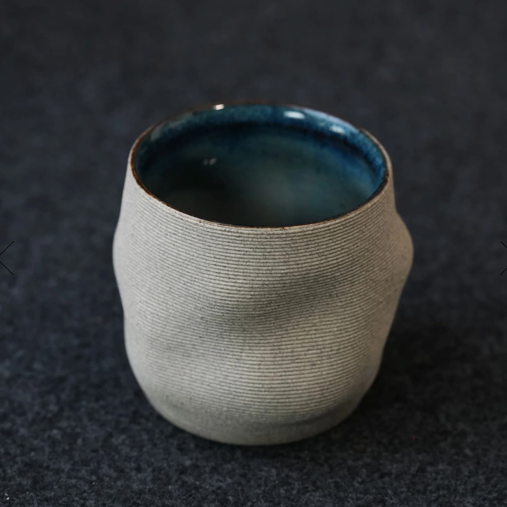

Few days ago I was trying to use that technique for a cup I saw but kinda Failed.

I found some success with this method. Maybe on your cup you need to make the sketch circle bigger?

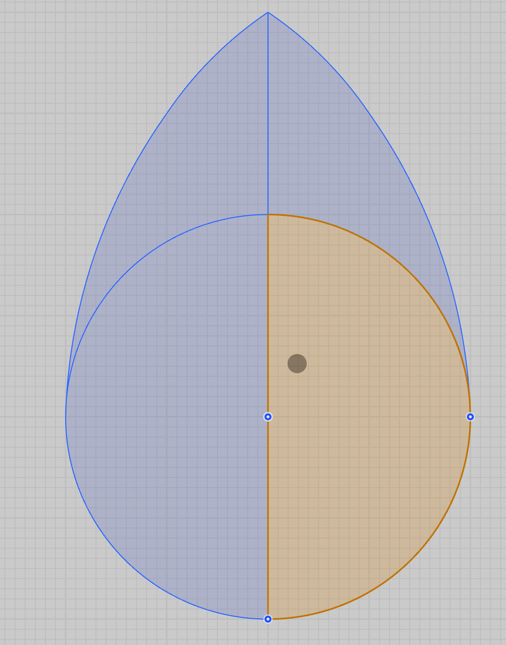

Or maybe if you changed your sketch profile to look more like a teardrop or something then you could get the overlap you need.

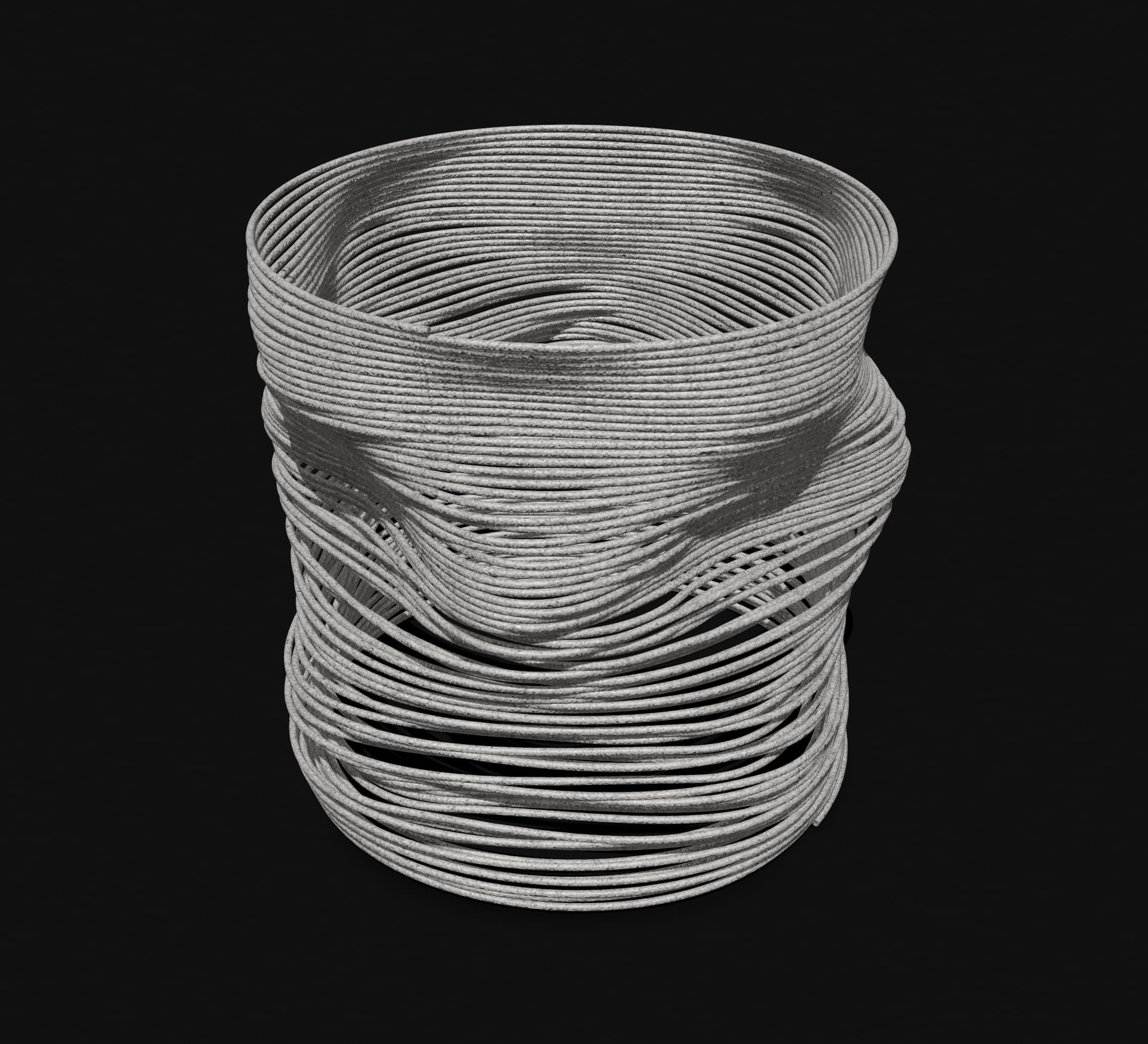

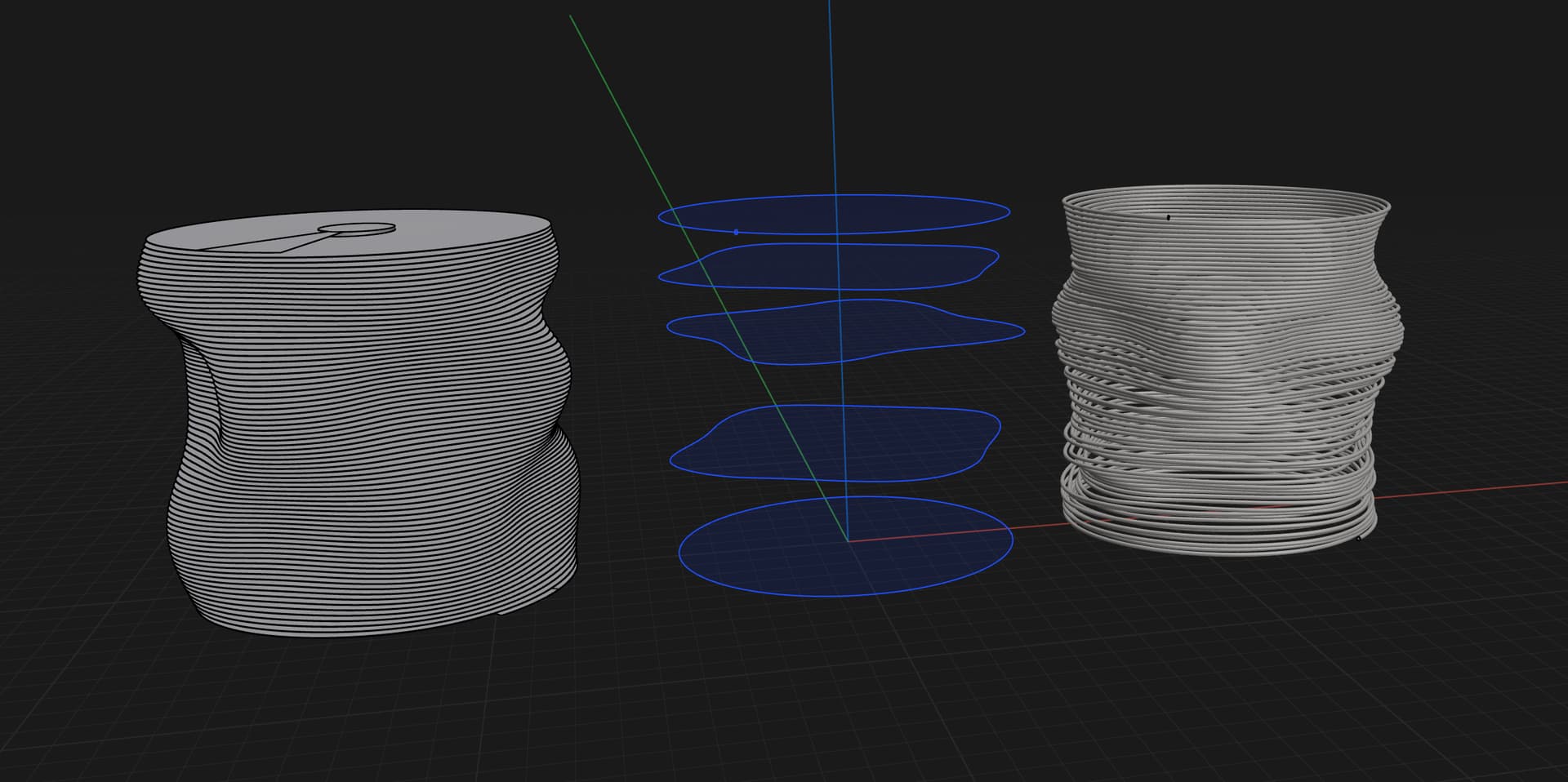

Yeah but it’s a good fail in an interesting way.
Thanks I’ll give it a try for the V2.

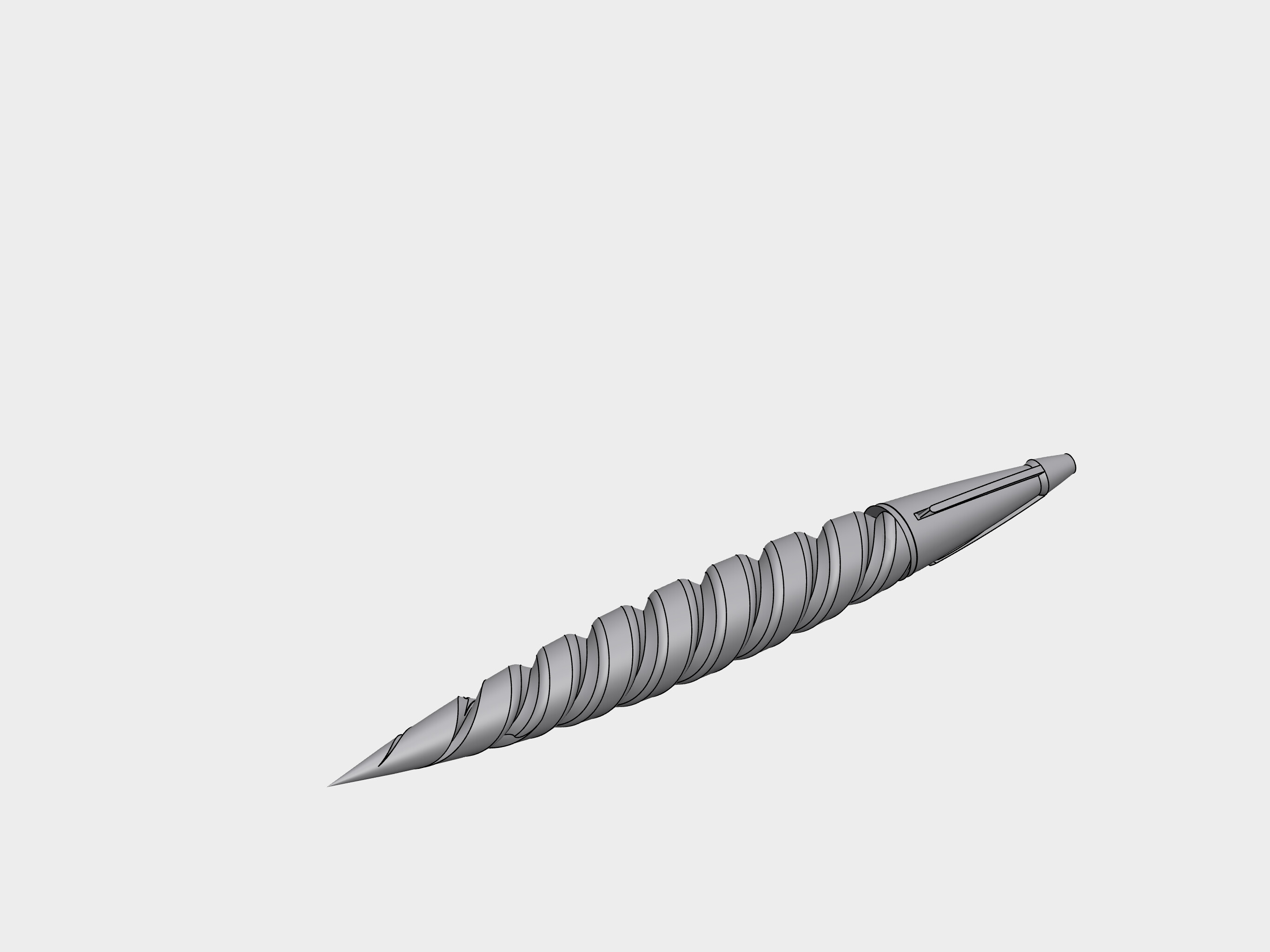

By the way don’t know what that is but looks pretty interesting, like a spear, very nice!
Oh and ya it kinda looks interesting, happy mistake and should still think about somehow using that to make a cup.

Yes I agree, version one looks great. May I ask how you got your cup to deform like that? Maybe the loft tool?
