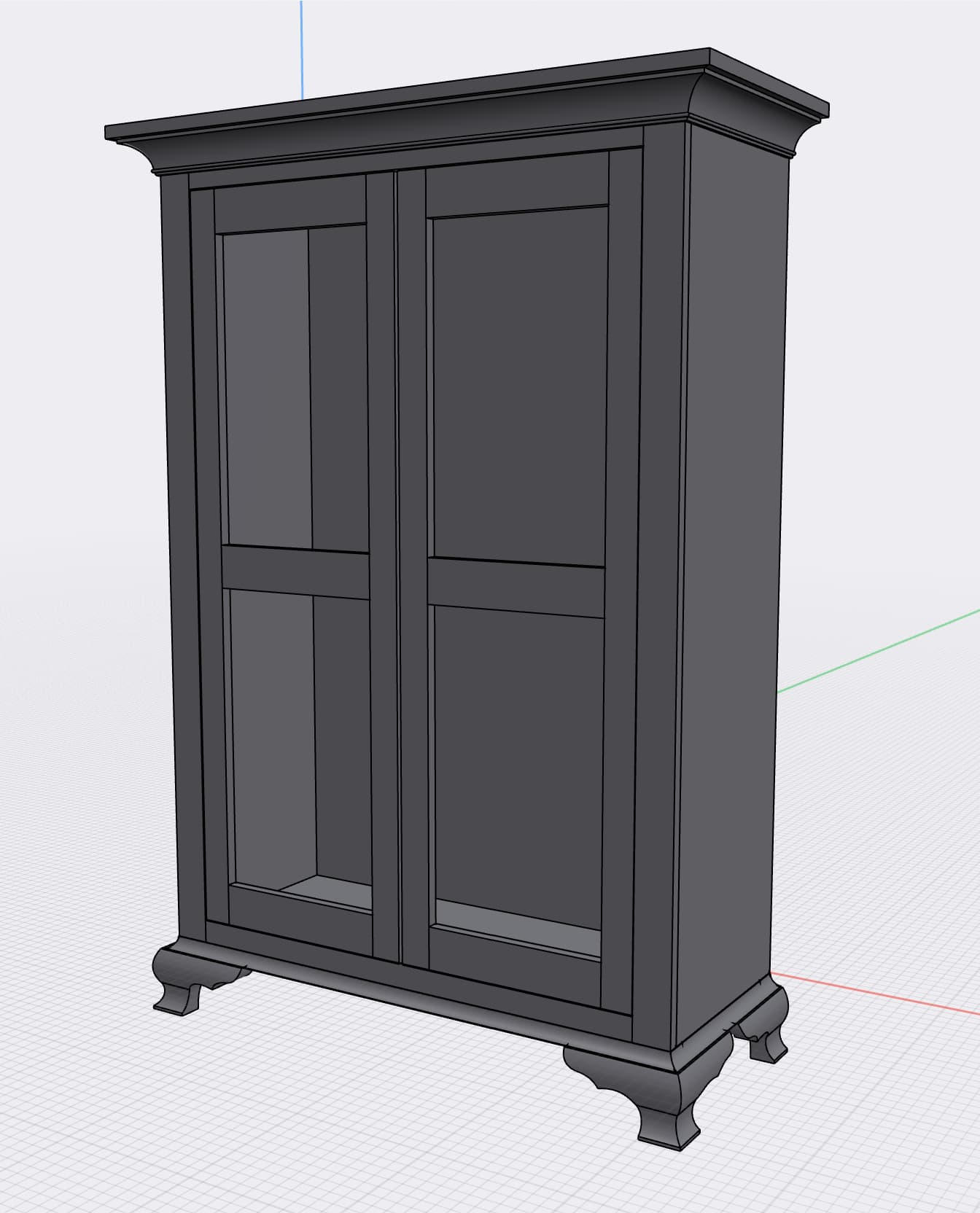

I’m so close to finishing this traditional style china cabinet. The base assembly of the cabinet will have ogee bracket feet. I produced the ogee profile without any issue. How do I go about making the scroll profile? I’ve attached a few images of my model and a few images of the actual bracket feet.
Well, I think I figured it out. I sketched the scroll profile along the back section of one of the bracket feet and then removed the material. Copy the sketch, rotate, remove, and repeat.
That’s how I’d have done it as well. When I read your post yesterday I was unsure what part was the scroll, I thought it might be something on the door panel but didn’t know so I kept quiet.
You did a good job of it on your own and the whole cabinet looks great :+1:
Thank you!
