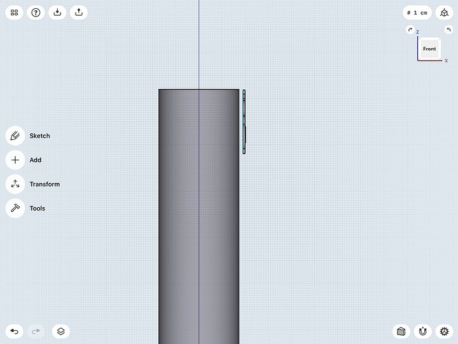

I have made it! But how can I fix it on the column ?
You can extrude the back of your column head to the center of the column and maintain as a new body. Then, copy/rotate the extrusion 90° three times with the center of rotation at the column. Finish off with a union.
