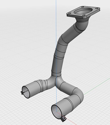

I want to create a 3D spline, to design a 3D pipe (exhaust)
May we create face or surface, and intersect them?
See drawing attached. Sorry for the strange language

KEKE63
October 5, 2025, 4:35pm
5
Many thanks, after a couple weeks, see the final pipe
