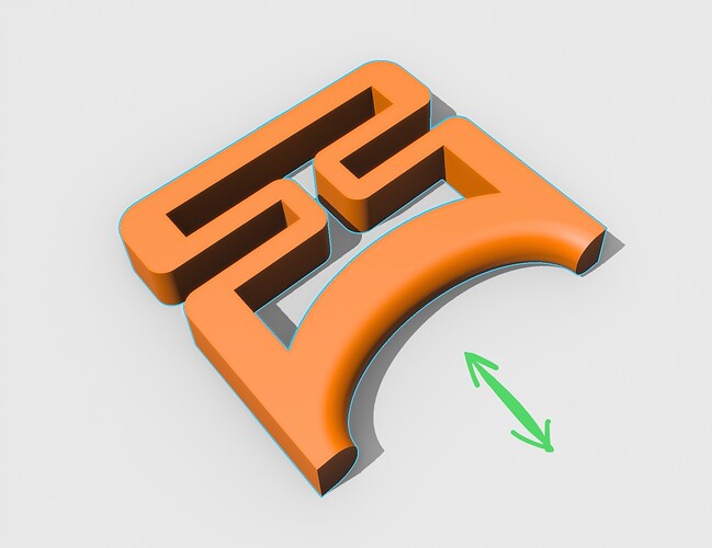

I’d like to modify the attached clip to be a pull latch to make it easier to attach and detach. I’ve never designed a pull latch before, so I’m not even sure how to go about it. Does anyone have any good ideas?

Maybe something like this:

Not sure what limitations you may have. If the clip is somewhat flexible then something like this might work.
It is somewhat flexible when printed in PETG, but I plan to freely share this design and don’t want to restrict the material.
PETG would be a great candidate. PLA may be a bit too rigid and PLA Pro might work okay. It all comes down to how much flex you need to remove the clip. I’ll share a couple of other variations in a few minutes.
That’s along the lines of what I was thinking. I’d beef up the upper part so I could make the push/pull rods thicker.
Here are a couple more variations. Worth doing a 3D print test if you can.
I just used this for an internal spring. PLA tough+. Repetitive use in a toy.
Interesting. I wonder how flexible PLA Tough+ is. Can you show a picture or two of your printed internal spring in the relaxed and compressed state?

Thanks for sharing. I’ve made a variety of similar ‘springy’ parts. I was just wondering if it was of a different configuration. Here’s one I did a couple of years ago. This deflector was printed in PETG on my Prusa Mini with a 0.25mm nozzle. The part is less than 12mm wide.
