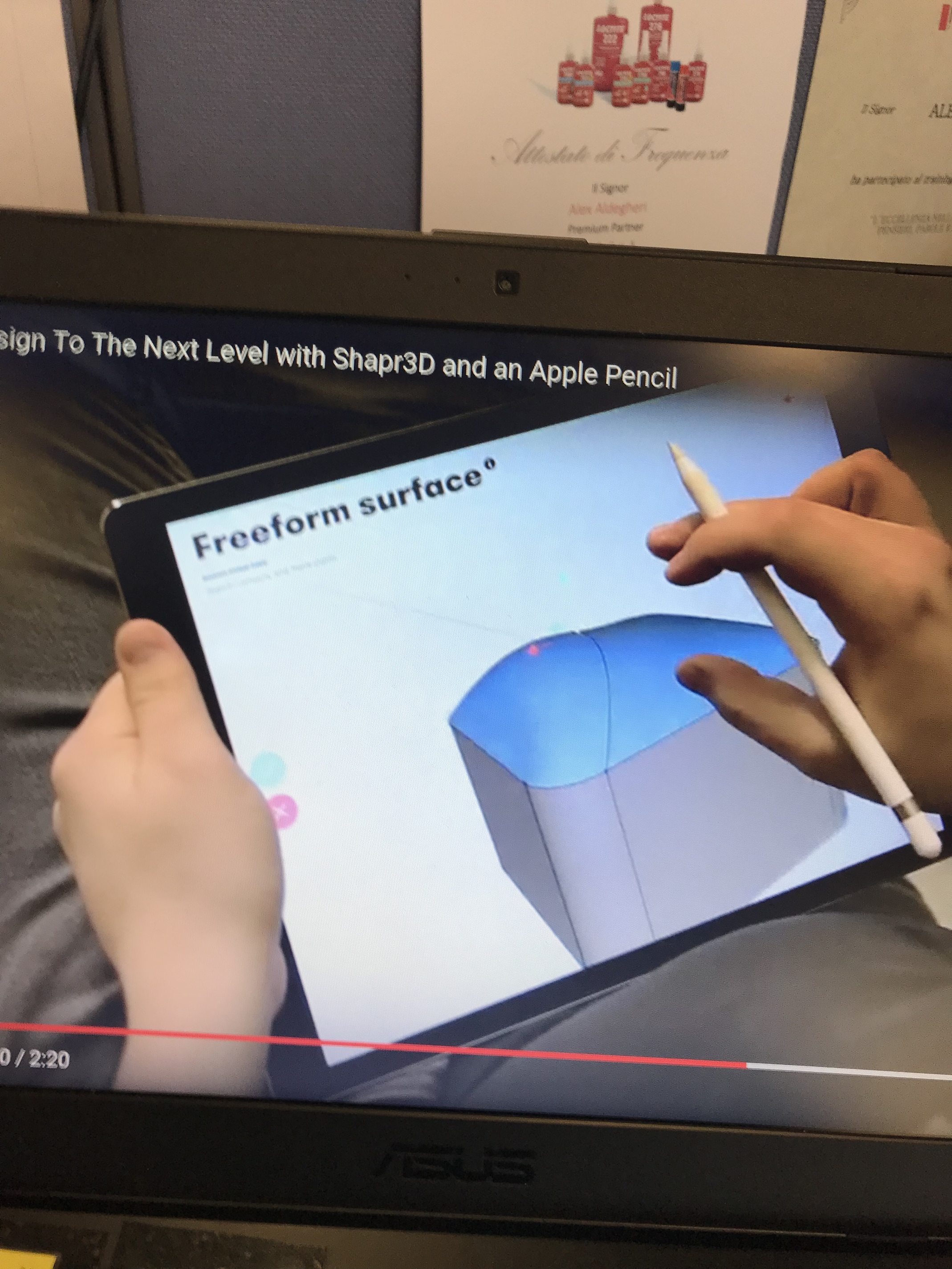

Hi, how do I find this option? I have the pro version but I can’t find it.image
Freeform surface
That feature has been removed from the 3.0, because it was not very useful, but soon much better freeform modeling options will be added to the app.

Hi - We haven’t added a specific tool for freeform modeling yet, but since the conversation above, we have added “Moving edges”, which allows you pretty big freedom in terms of creating freeform surfaces: https://support.shapr3d.com/hc/en-us/articles/360004724573-Moving-edges
