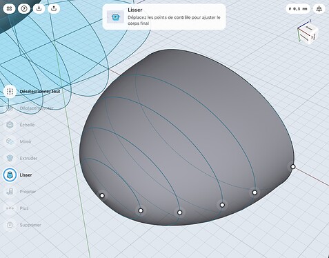

I want to make a human heart with the left ventricle (bi-axial ellipsoĂŻd: easy) and the right ventricle (tri-axial ellipsoid).
I had to bild my ellipsoid slice by slice:
with a tiny disk on the top of the ellipsoid:
then use the loft tool:

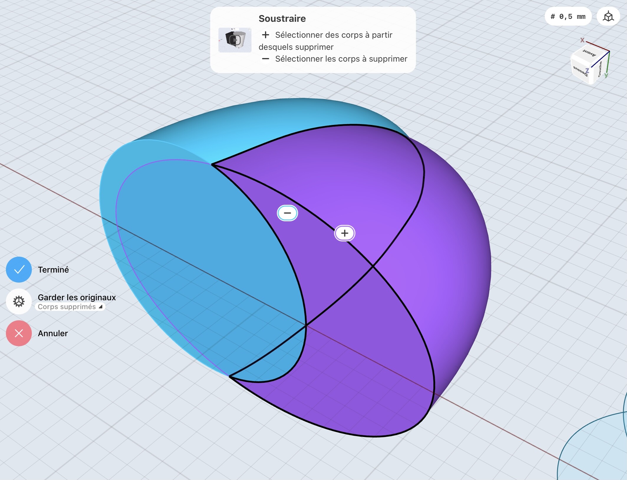

the top isn’t very clean and make the shell tool impossible, so I had to hide the top of the right ventricle by making a rotation:

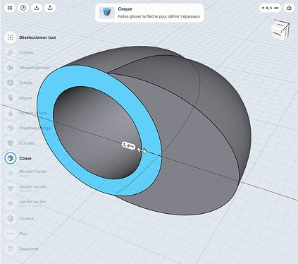

and then substract, shell and union tools:

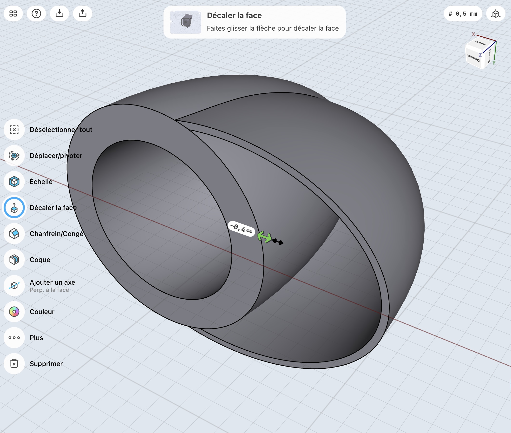

I made disappear the inner wall of the right ventricle by giving a negative value to the offset face tool:
