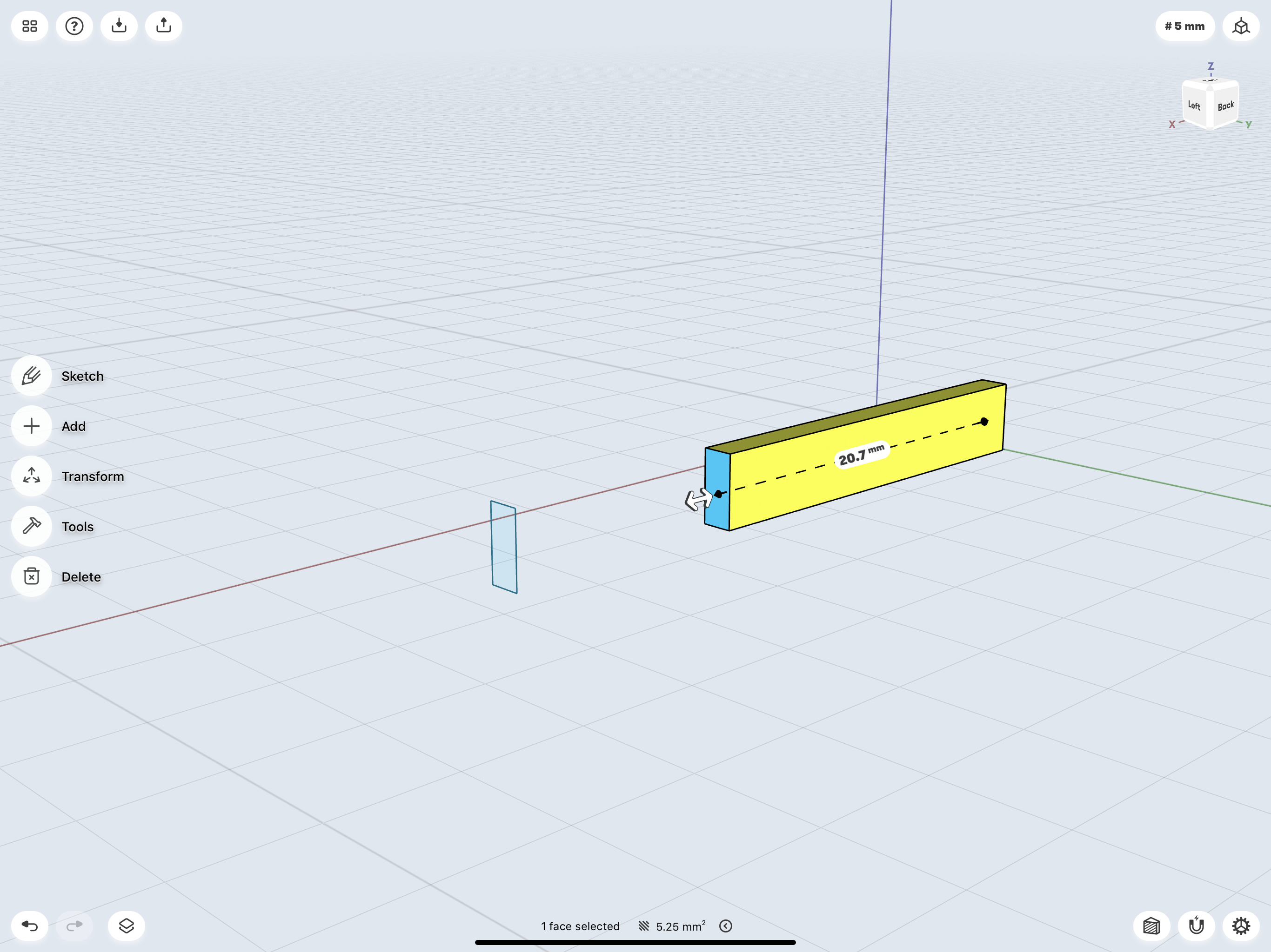

Do you want to extend the Rail to meet the Rectangle?
If so it looks as if you could simply Select the end of the rail and pull it to the Rectangle:
If this is not helpful just shout.

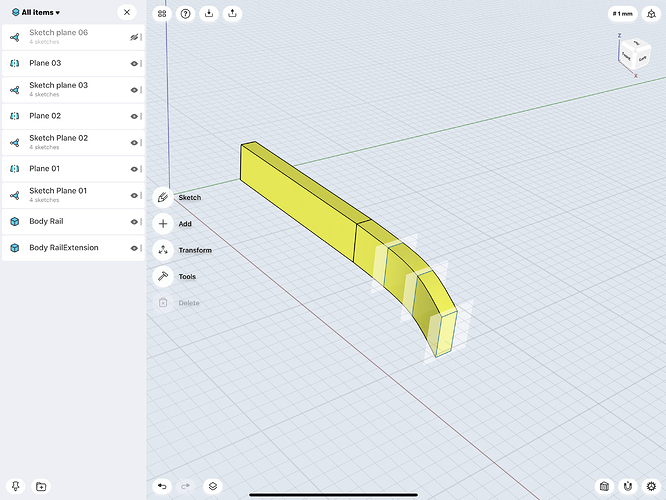

It does not look pretty but this is a Tools > Loft from the end of the existing Rail to the Solo Rectangle:
Using a set of Add > Construction Plane then Tools > Loft based on the Rail End may work [MODIFIED]:
