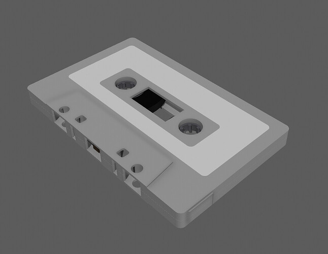

Sometimes I model some useless thing just for fun like these on photos:
Or something more useful :slight_smile:
This CNC was assembled after that and working.
