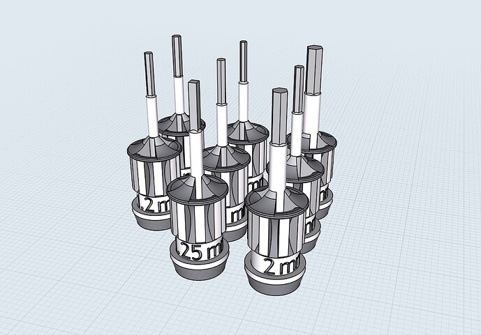

Screw drivers
Nice, but do they ratchet?
Happy holidays,
No. For my needs it’s not necessary to use a ratchet.
Happy holidays!
Impressive! I was being facetious re the ratchet. Sorry
Happy holidays to all…
Looks great! What did you use to cast it?
Chromium cobalt alloy with hardness 320HV and casting unit with high frequency induction melting and centrifugal casting.
