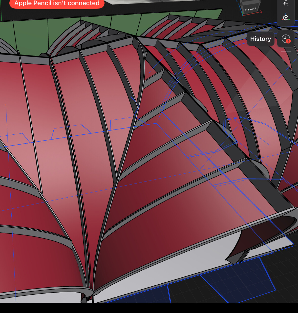

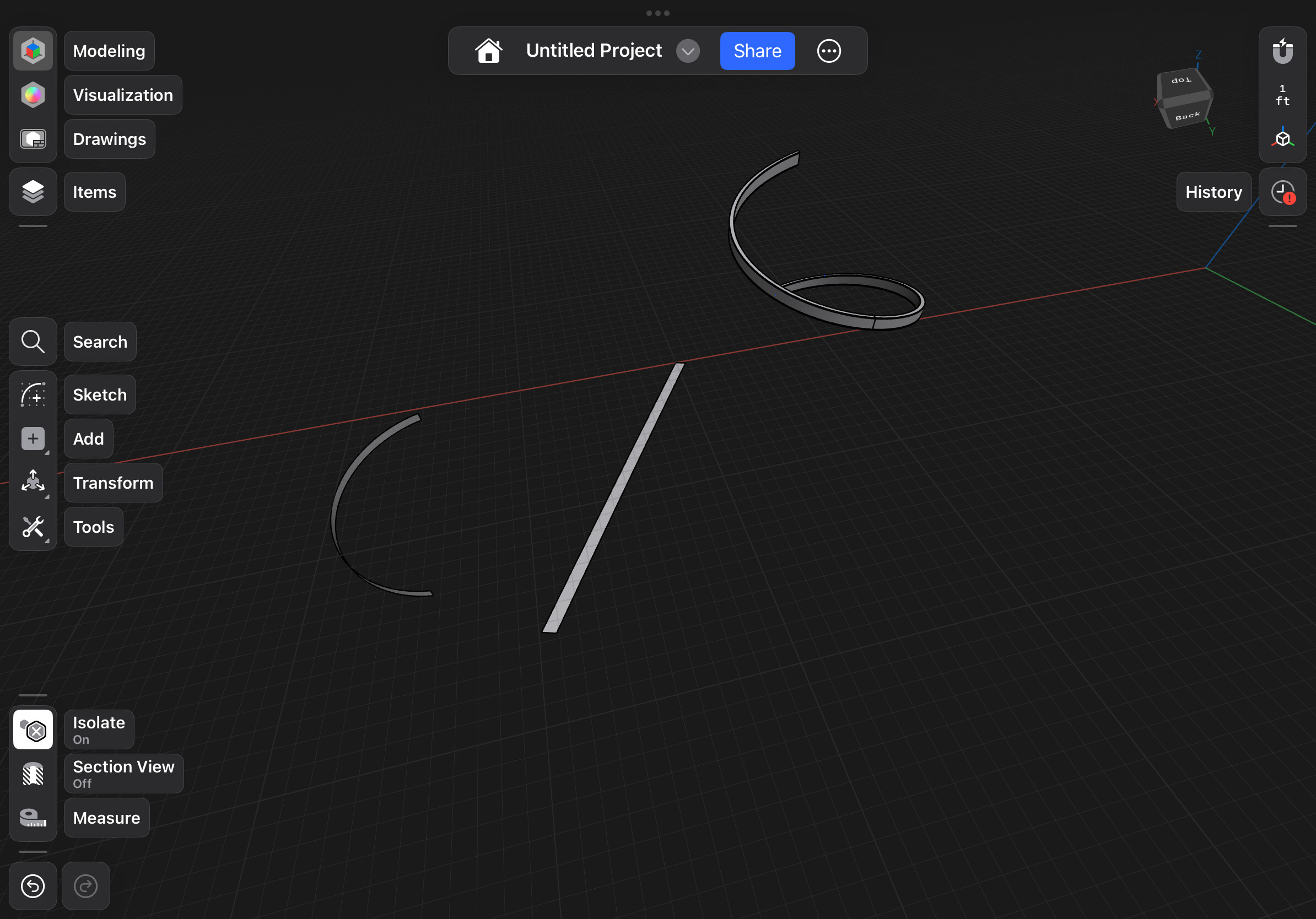

Hi, here is an example of the kind of shapes we deal with And some screenshots this is a basic stringer and I know how to manually unroll this , but for speed I import it into rhino as a step file . explode surface copy surface and then unroll surface , then reimport it into shap3r this is quite long winded and not all people have access to rhino ,the new isolate function helps this process but to have this feature in this program would be so handy ,
I deal with quite a few developments of shaped ellipses ,volutes , helix , ect , I’ve attached some photos and hopefully this helps

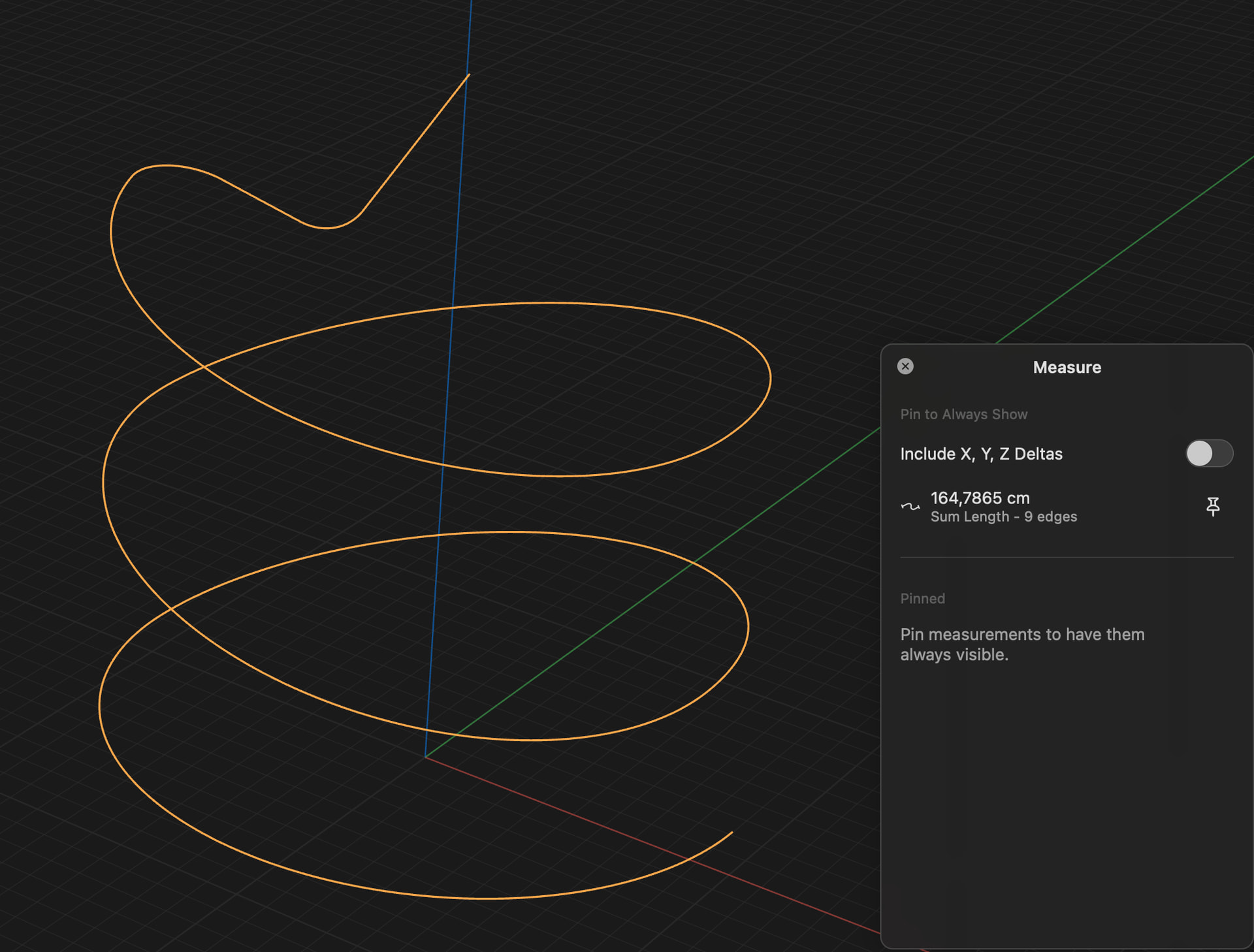

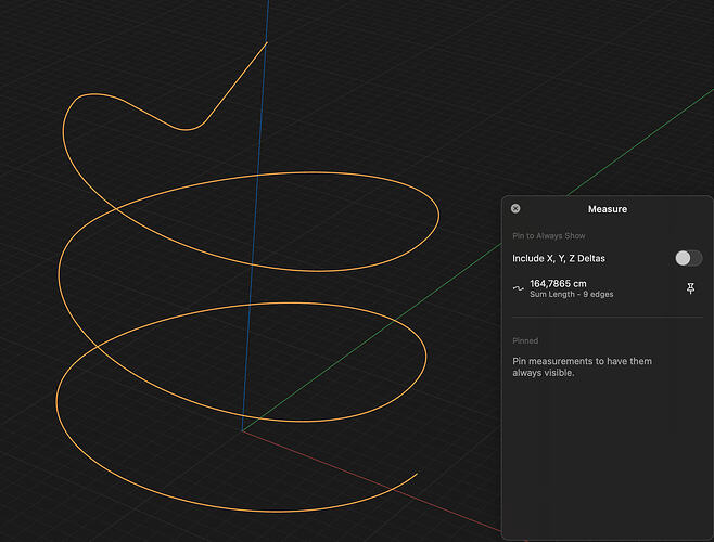

I see simple shape in your screenshot. Perhaps you can use Measure tool quite simply.
Hi , @jean-philippe2
Thank you for the reply ,that shape was just an example of how to unroll with rhino , I will attach a more complex shape to assist in this example

Heres a roof that could do with the help of unroll
measuring that would not work unfortunately

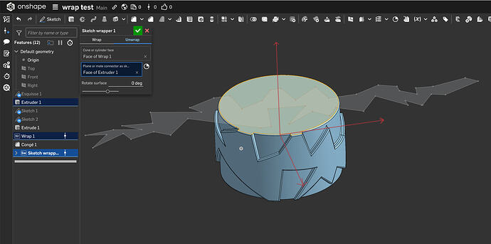

Personally, I export to MoI3D, Plasticity or Onshape to do this kind of thing.

On Shape 3D CAD on Ipad
Wrap and Unwrap
Hi @jean-philippe2
Is this the free version of onshape or paid ?
Yes the Free Version.
And you can upload a lot of free FeatureScript as Sketch Wrapper
That is a very unintuitive UI I couldn’t find the unwrap /Flatten feature anywhere
Rhino is easier by a mile I just don’t like drawing with it
How to unwrapp (Onshape), It’s a method
or you can upload the free FeatureScript: Sketch Wrapper and see my screenshot above
