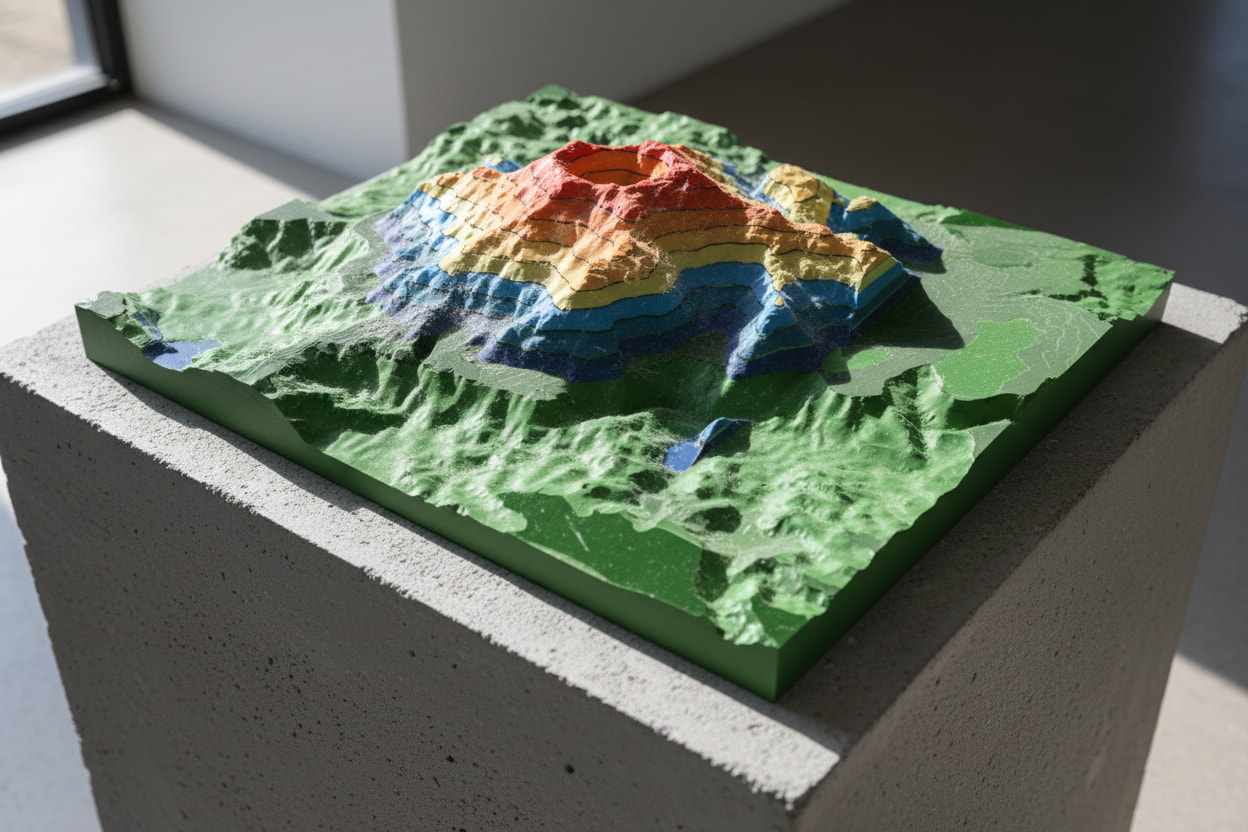

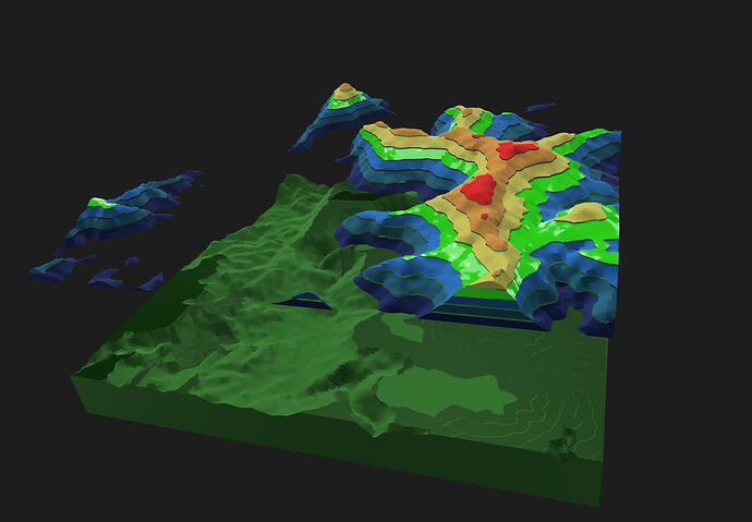

My purpose using Shapr3d instead of QGIS application for topographic visualisation is to quickly share to clients with limited precious time and need visual representations of properties for quick assessments for planning real estate development or just “feels” of the terrain. Downloading a digital elevation model from a website, then exporting to Nomad, then exporting to Shapr3d as an .stl file, I can create multiple planes (pattern), then easily slicing the stl terrain into sections using split body, then just simply hiding the sketched plane.
