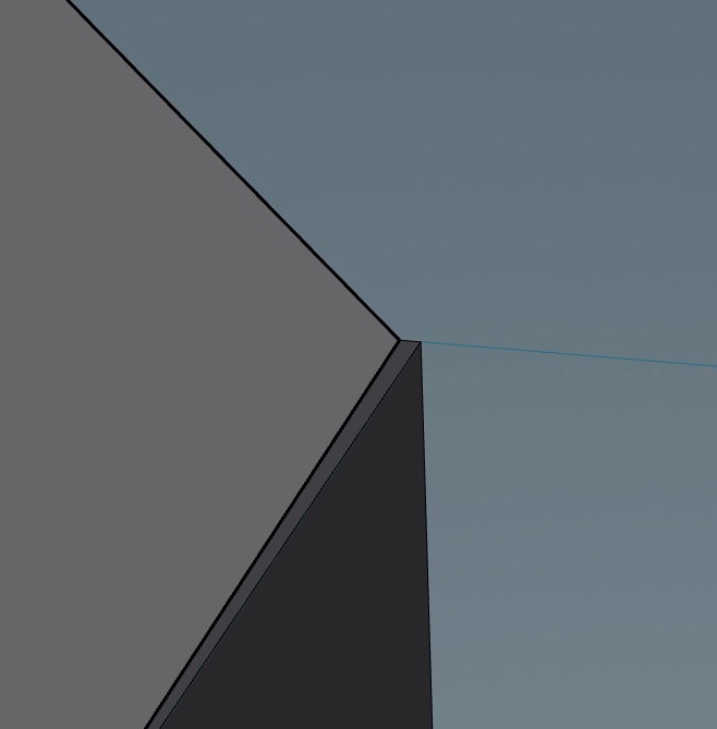

I can not rotate this face 45° as I did with the lower part and I dunno why.
I pulled up the first part of the block sketched a rectangle on top to be able to separate at specific height and then pulled up more. I can not rotate that marked face and I dont understand why.
and rotating it looks like this. The face gets demarked and nothing happens rotating.
What am I doing wrong please?

Wont work either. I deleted all sketch planes and just drew a line on the face. It looks like this rotating the upper face around that line.
But yeah the sketch plane is rotated but why cant I select the face?
Isn’t this clearly a face selection?

This is my problem. Second marked face should work as full face. I clearly marked a face not a sketch.
All you’ve done there is made a sketch and rotate it. You never made or extruded a new face to rotate.
I get it still strange extrude and other commands see that marked part as face and move/rotate does not but as sketch. I think move/rotate should handle that part as it does a full face. For moving a sketch you should mark the sketch lines not a surface. At least that came by personal intuition. You can move/rotate while in sketch mode you know at least on Mac.
