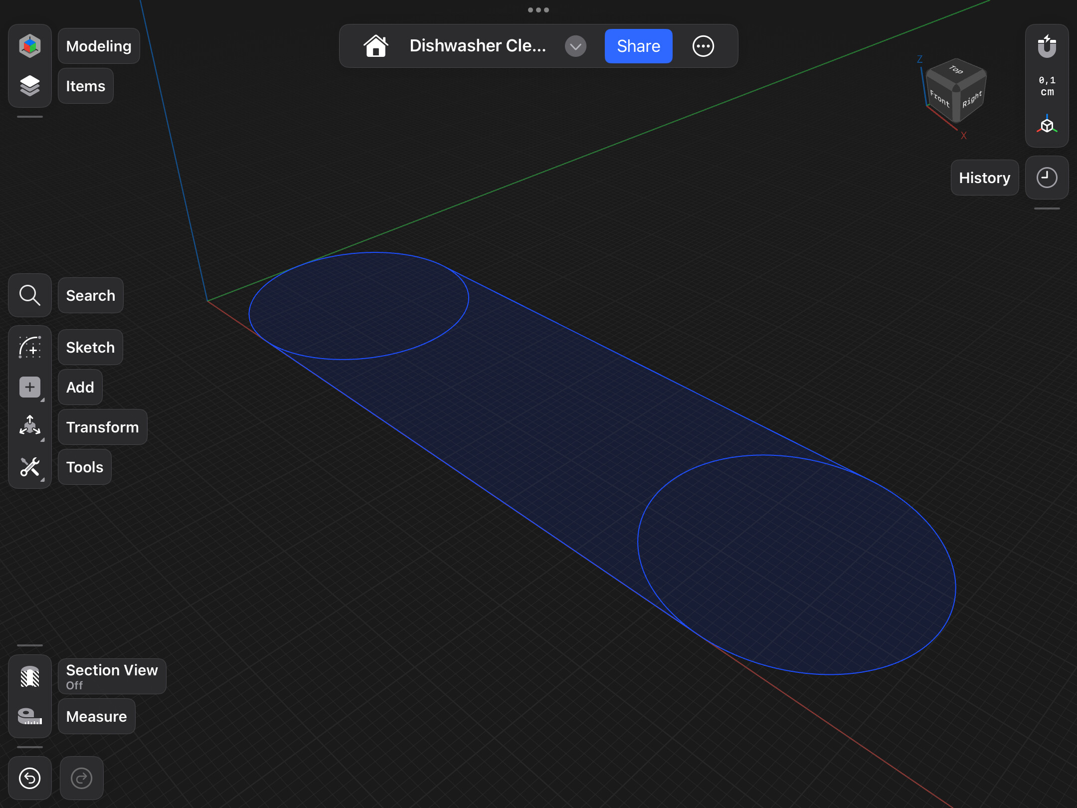

Connecting 2 circles to make body
It’s a simple design, but I can’t seem to get the lines to connect with the circles in order to create an extrudable body. What do I need to do next?
Thanks,
Mark
Dishwasher Clean-Dirty Slider 01.01.shapr (92.8 KB)
I opened the file and it looks just fine, here’s how it looks:
Just make the lines coincidence and tangent to the circles.
Don’t do like that. This is your circle and line above it.
From the bottom of the circle line event not intersect with the circle
I don’t know how you achieved this horrible result but here is how it should be done.
Got it! Thanks for the replies. I moved both ends of both lines until the “intersection” comment popped up and that did it.
