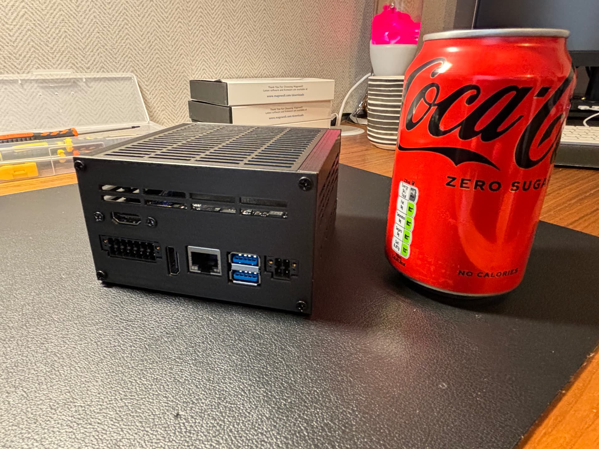

Custom case for Jetson Orin NX/Magewell Capture build
I had enormous fun creating this in shapr3d (my first project) and printing on a Bambulab P1S.
It involved lots of fine-tuning and many “takes” to ensure the components fitted as tightly as possible.

So what I’ve learned is that PLA is not suitable for a case this size! One of the top panels has warped with the heat of the NVIDIA heatsink/fan.
So I need a tougher plastic if I’m to keep the same compact size. I’m currently looking at Bambulab PC as it seems relatively easy to use and has much higher heat resistance. I can’t use things like ABS as I don’t have the great ventilation where the printer is.
