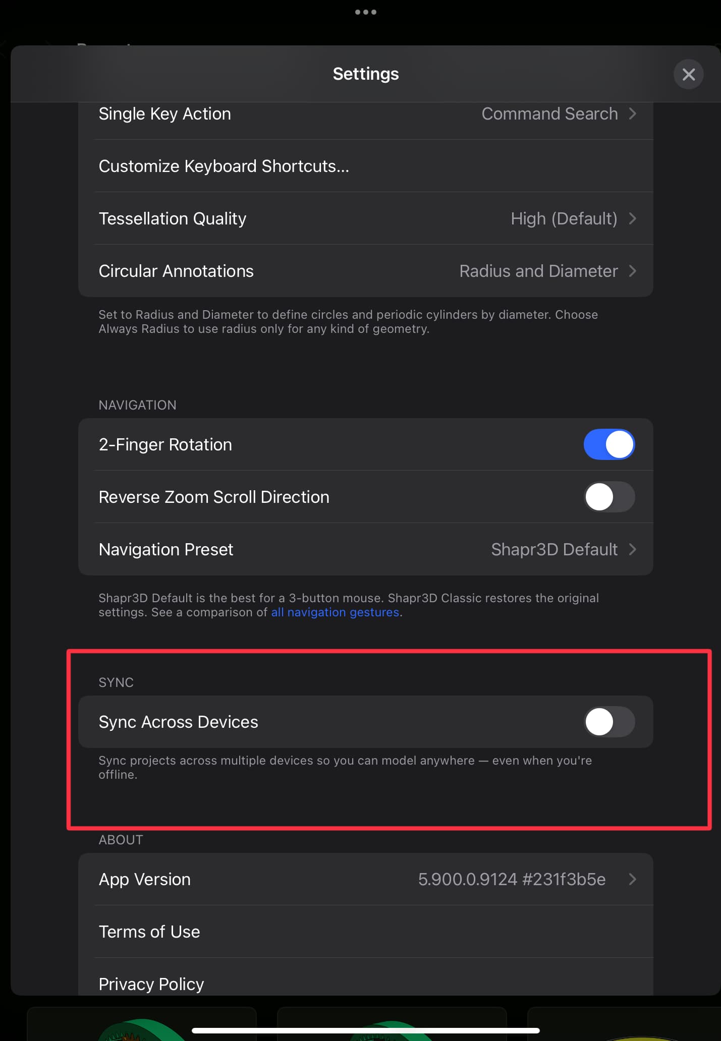

I found my old WIN PC has the old Shpar with SYNC OFF feature! :melting_face:
Gotta see what happends.

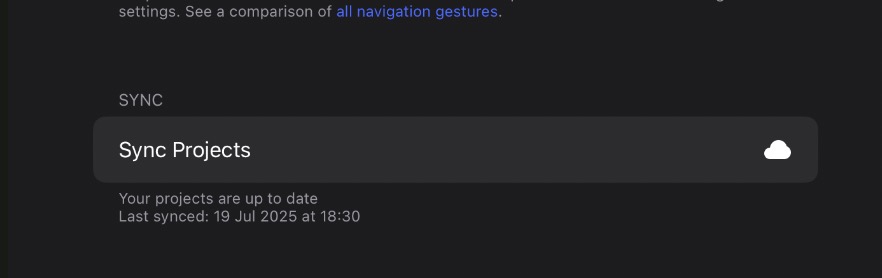

If I toggle it off, I would just keep exporting out as Shapr PC and reimport it Shapr iPad via various methods sync or non sync options.
Also my iPad too doesn’t have the toggle, so he must be on some other version.
