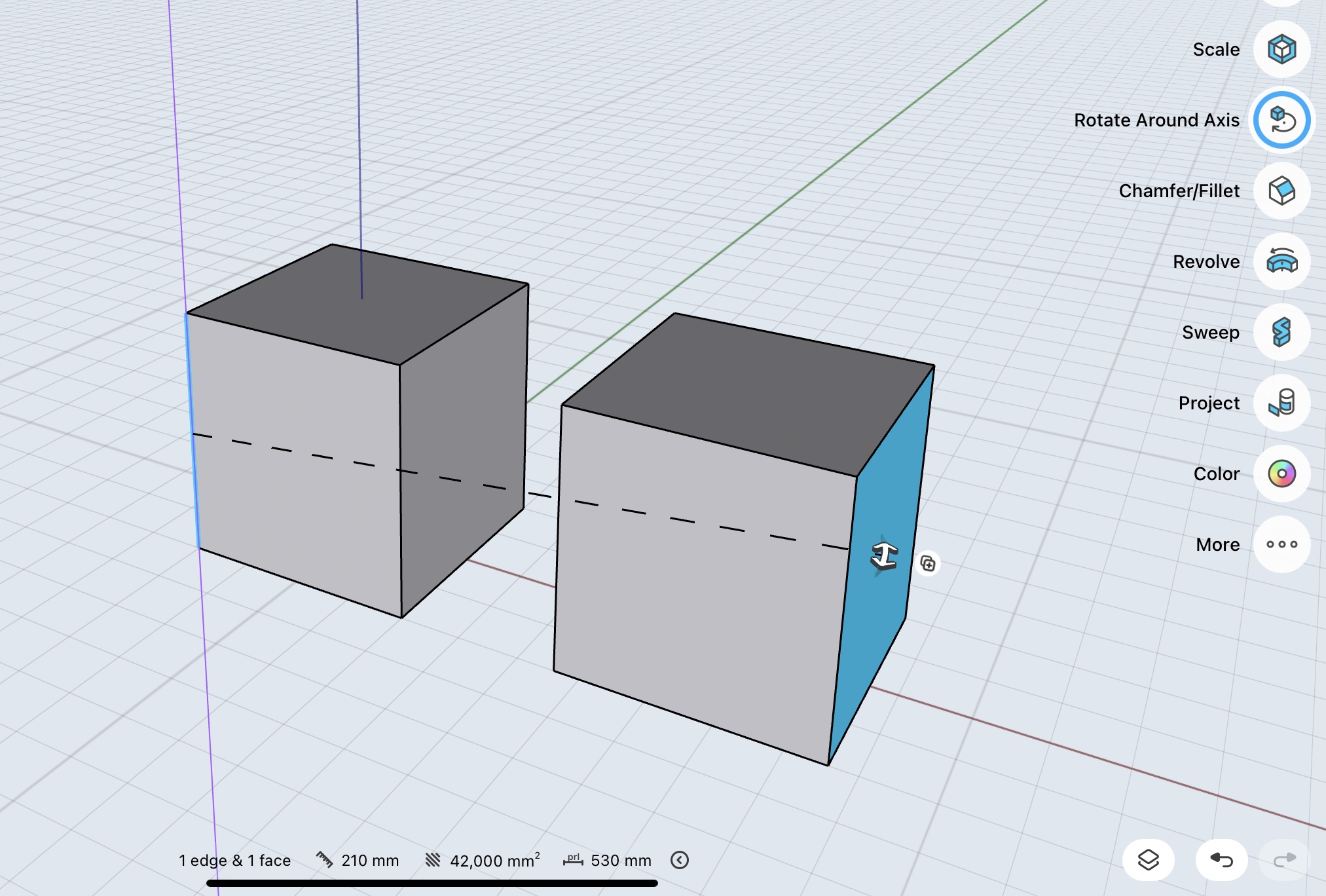

I’d like to measure the outside distance between two objects to make sure they are the correct distance apart. But I can’t find a measuring tool, how is this done?
The info at the bottom of the screen does not show me this when both the objects are selected.
You might have closed the messurement panel. Tap on the small arrow. Can you share a screenshot?
Sorry for the delay in answering, it would be for example the two corners marked.
Which small arrow would that be?
For those 2 corners, measure the distance between the two vertical edges.
Also works with an edge and a side, or two sides.
Great thanks!!
