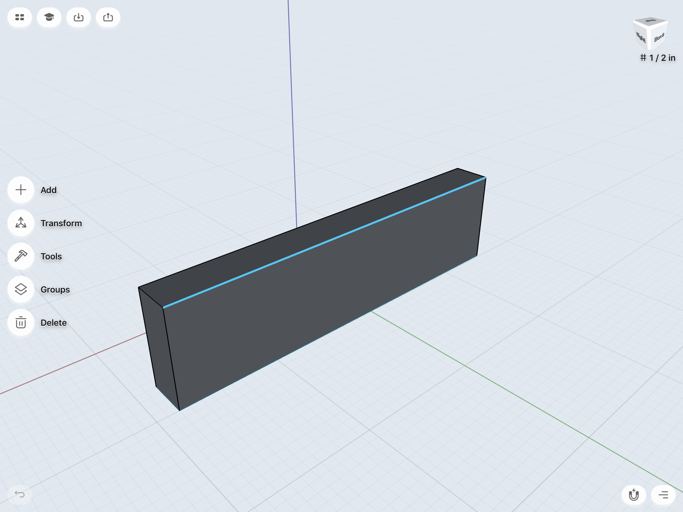

Edges.shapr (396 KB)
I tried reproducing the problem in a new Workspace — starting with two separate squares and could not do so.
But encl is the original Workspace which shows problem ( I hope). I believe that this body was Extruded up. Ss1;select edge by clicking with Pencil; note nothing displayed at bottom of screen. Ss2; select opposite edge (now 2 edges selected) bottom of screen shows only 1 edge selected. Deselected both edges and selected vertical edge; display now correctly shows 1 edge selected Ss3.
So the problem seems to concern edges on the face that was extruded.
Hope this helps…
Tommy
And if you continue to select all edges, only 10 edges will be displayed. And they are indeed all 12 selected.
Hi- thanks for the workspace, it will be much easier to investigate like this. I see the problem now, thanks for the report, we will look into what can be behind the issue.
I have redrawn that one line that had the problem (it is always the longer edges of the face from the first picture), the Selection info worked again.
