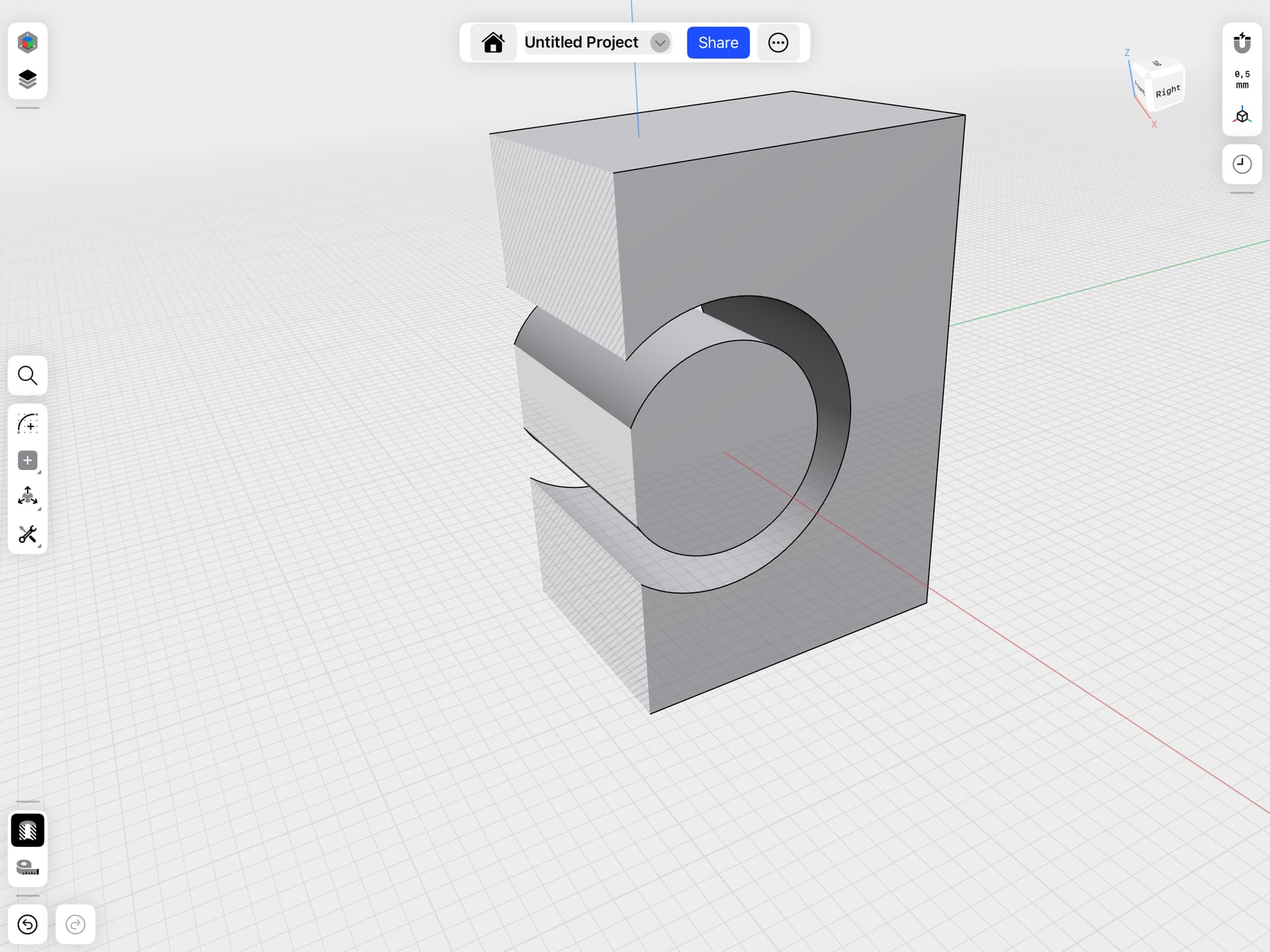

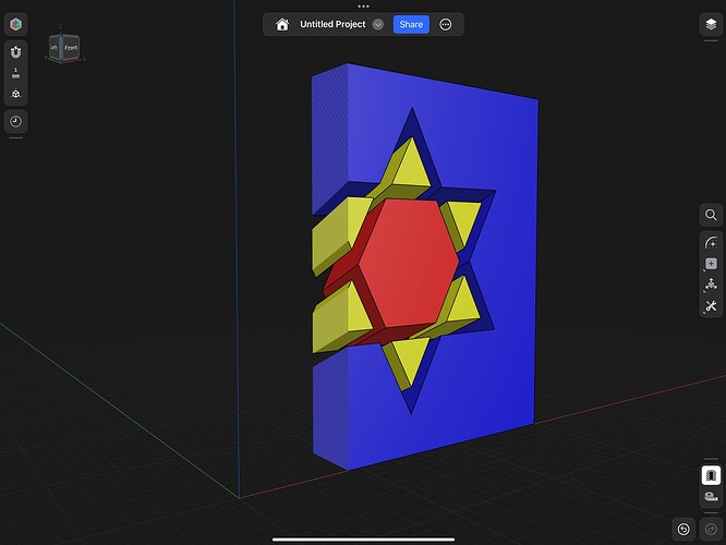

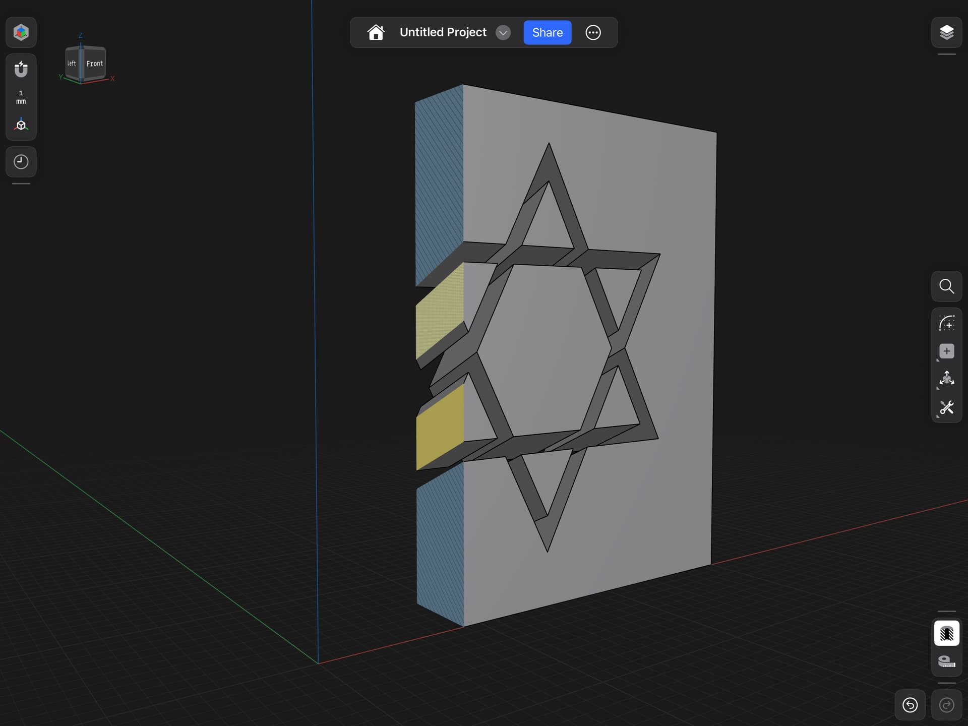

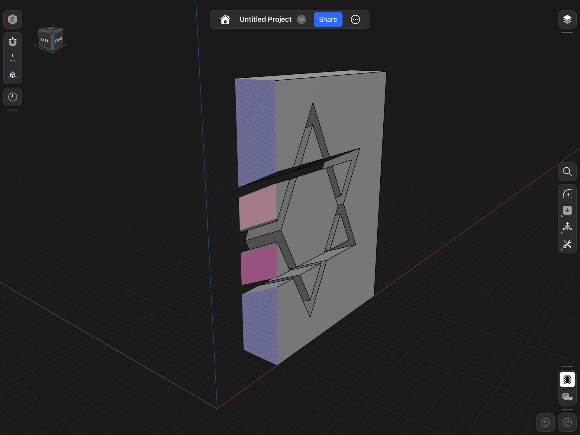

Now, what is the correct way to use the section view? Yours has a colorful view, but not on the iPad…:face_with_monocle:
iPad shows me the same.

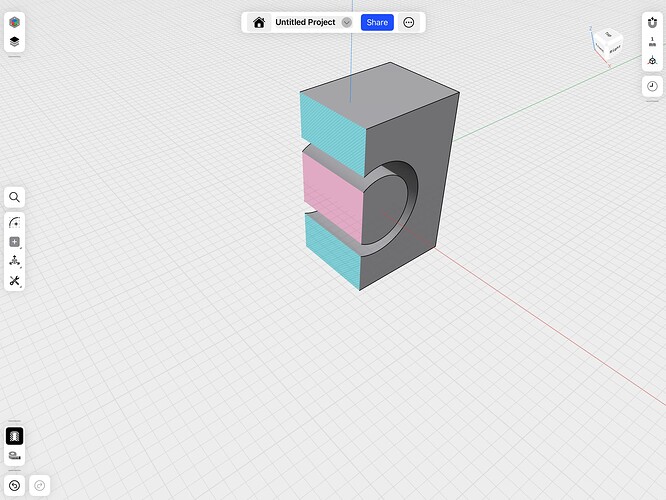

I think colors and line fillings are chosen randomly.
strange, at the time the section view was released it was also colorful for me…
Looks something wrong with my old models…
Looks, something wrong vith the yelow..

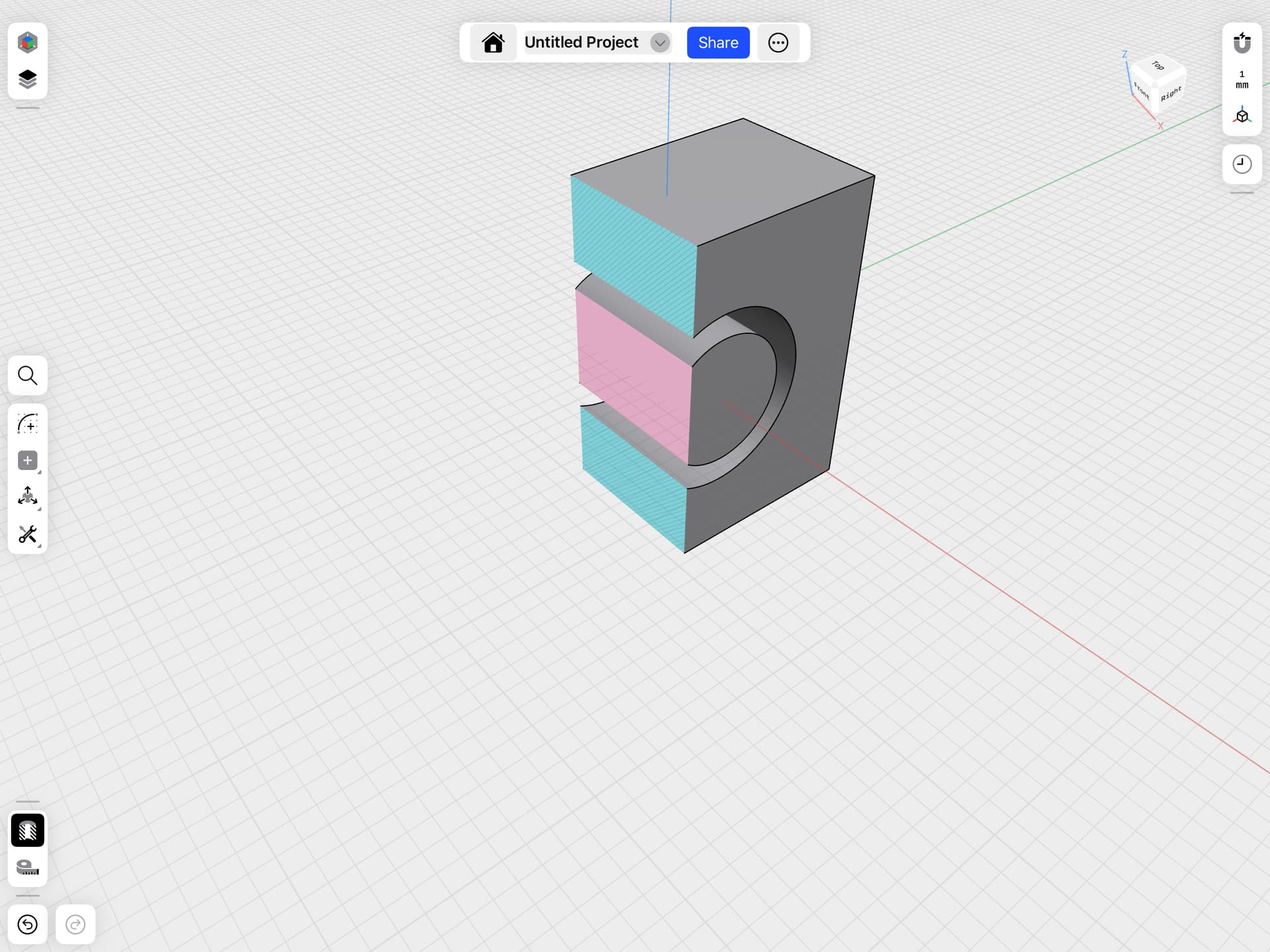

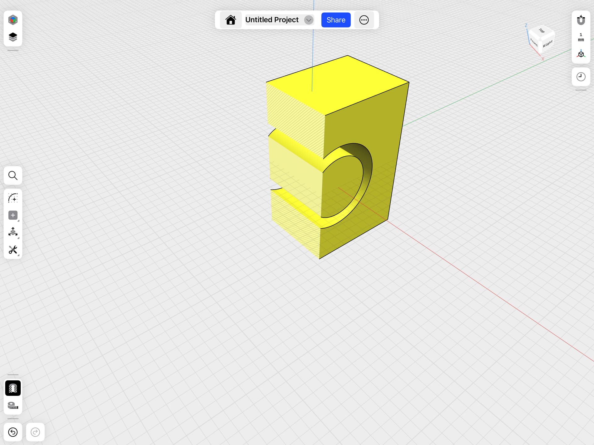

Not with yellow. Then you change color of the body it starts to show exactly this color in section view. Random colors used the default color and material used.
Changed the color again, looks bug
Not a bug. It just respect your choice. Reset color to default and you’ll see colorful section again.

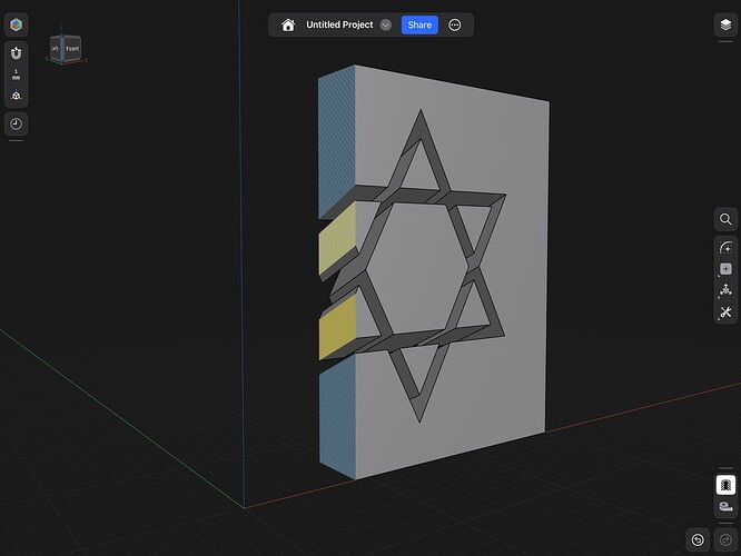

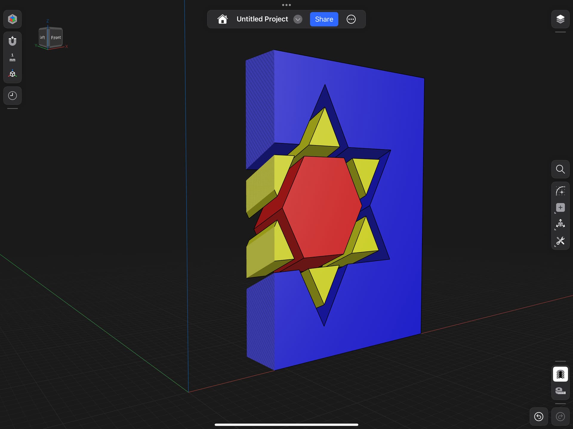

My colors
After resisting to default
I’ve already reported it to the developers twice, and they admitted that it shouldn’t work that way. It used to work with yellow too.

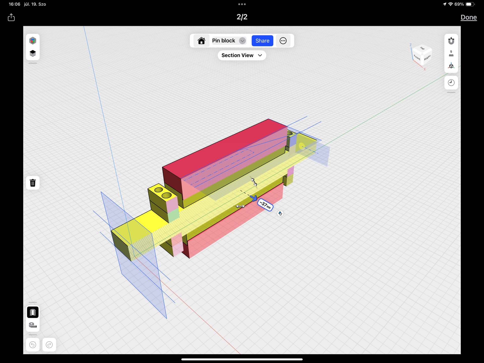

The attached image was taken a while ago. I used to be able to change the colors of objects that are touching each other. I think this would be the correct way to do it. For example, if I later return to a work that has already been recolored, I would have to restore the base color to see the section clearly…
