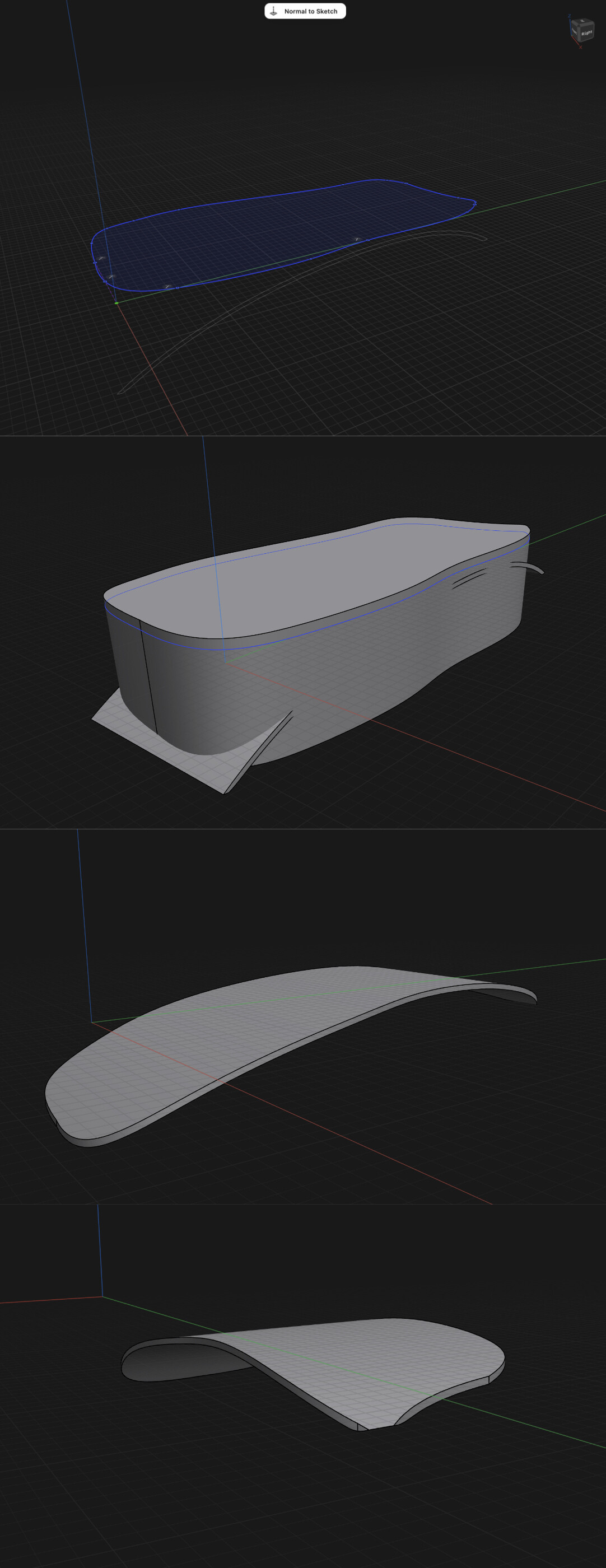

Hi, I’m new to Shapr. I want to create a roof with a very irregular shape, but I also want to keep the ability to make adjustments to the rest of the body. Right now I’m creating two bodies based on the side and top views, then splitting them to get a third body that matches the roof shape. However, that resulting body cannot be adjusted (as far as I understand). Could you tell me how to do something like that while keeping editability, or point me to a fairly recent tutorial?
I can only assume you’re referring to the intersection. However, it’s hard to give you any advice without understanding the shape you’re working with. Your sketches don’t help — at least not for me — to understand that.

Ok, sorry for that, it’s my second day using this program. Yes, you are right I’m doing intersection. That’s roughly the shape I’m working on. I want to connect more stuff to this sketch, so I want to be able to create that body without doing intersection.

Intersection is totally ok and used quite often to get this kind of shapes.

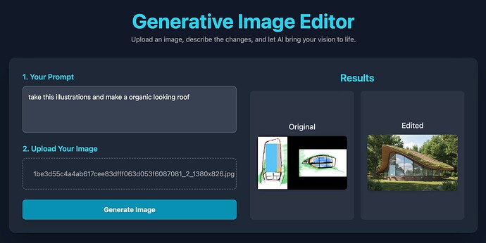

Gemini got tired of me asking for images and made me a Gen Image App! :upside_down_face:
Instead of a roof I think it works better as bench.

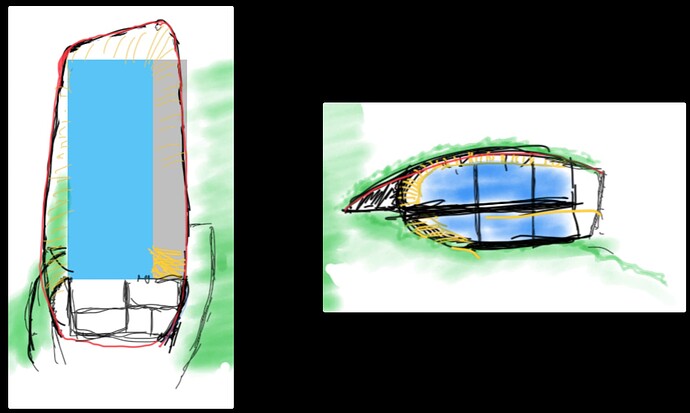

Good stuff! I like your approach. My plot is located on the side of a hill, and to get sunlight throughout the day the house needs to be positioned perpendicular to the slope. I have an idea to design it so that it looks as if it emerges naturally from the ground, almost like a remnant of some geological event. The supporting structure for the roof will be a sculpture resemble trees, and there will be plenty of wooden details and curvatures to break the bunker-like feeling. Some basic idea sketches are here: (i need to put it in one media because that’s the limitation for new users)
