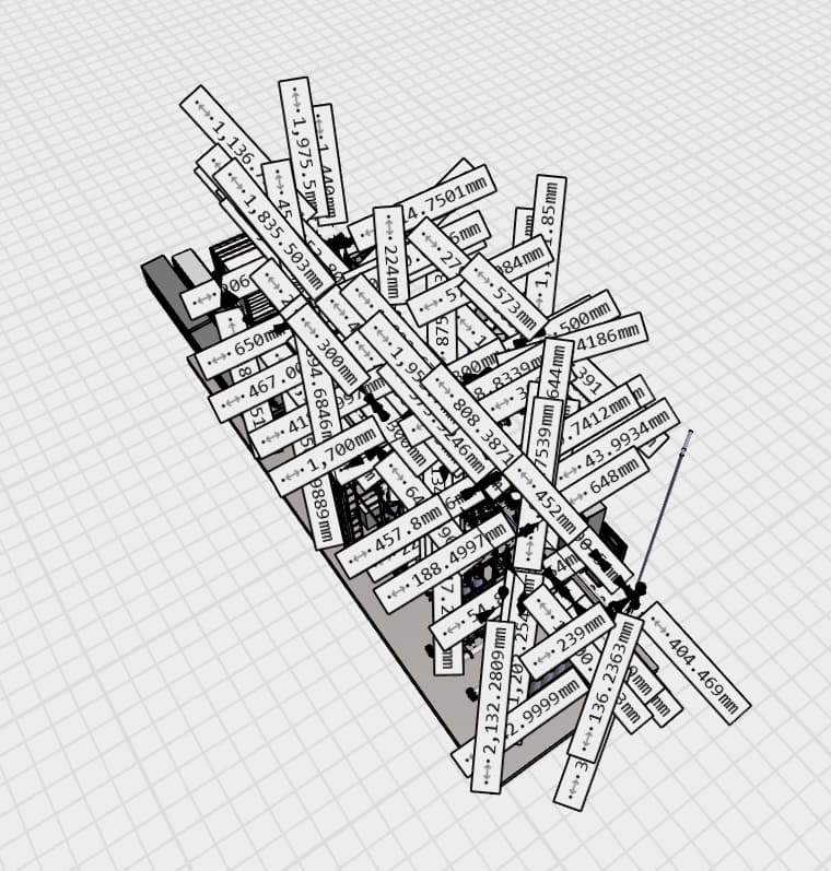

I, and probably many others really need more measurements. If I click on an object, I want it to show the length of the object, not just the diameter. The diameter is a constant for large part, but length is the variable, that needs measuring. I need to measure lengths all the time, and with the “point to point” measuring it is very slow and inaccurate, because the right points are almost impossible to find sometimes. Would be great if i could just click click click it into a list while not holding any button like shift or anything, so it would need it´s own tool
and if I take a lot of measurements, things get clogged with the tags. Check this out :smiley:
