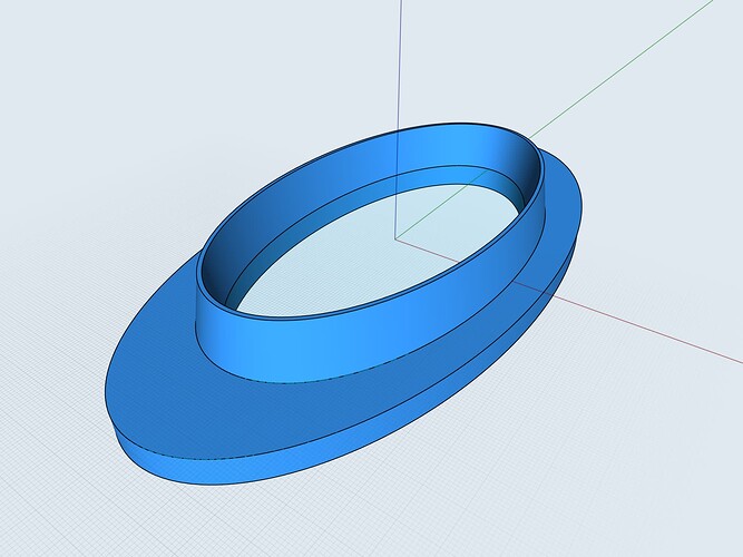

I would like to create this kind of cutters. With a « fat »side and a cutting side. Im on it since yesterday and I can’t find a good way to do this.
If someone could help me it would be so nice.
For now I created this kind of cutters, it’s nice but the first one is more solid.
And sorry for my English :sweat_smile:
Hi there! You’d like to make a design closer to the dark blue one or more like the light blue one? Or something in between?
Like the dark blue one.
Are you looking to make it like a cookie cutter? Like this?
Yes exactly but more like this :
You could use extrude with angel
Or chamfer
Many approaches
Well, TigerMike already provided a nice clean solution. :slight_smile:
I’m posting a proposal anyway, you might find it useful:

Here’s another method using Sweep.
Thank you so much ! There is still some tools that I don’t understand and use properly.
I’ll have to work.
