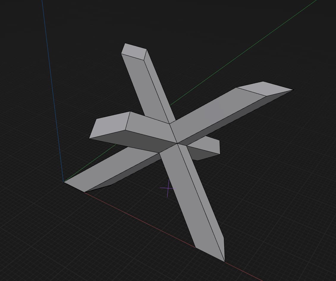

I was thing similar: welded tube frame and bored oak (or 4 pieces glued to make a hollow 4" x 4" members to fit over the tubes.
So if you look at my versions and the evolution it got thicker and thicker it was because I thought metal core would do the trick.
So from there, wood thickness would be just an illusion.

My double x leg example is bit different vs the WAYFAIR, First its bigger! Have no idea how heavy it is, I’m not Glassworker, but can guess its very heavy. I’m sure there is some formula to figure out material strength, also there should be some hidden reinforcement embedded if it’s all wood.

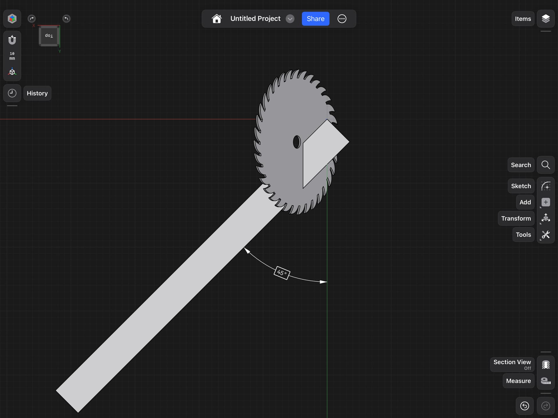

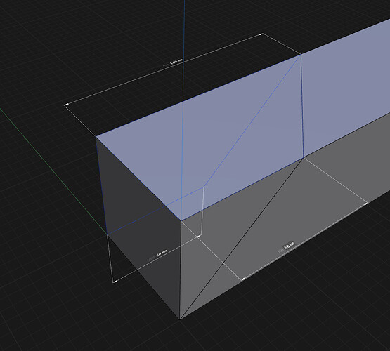

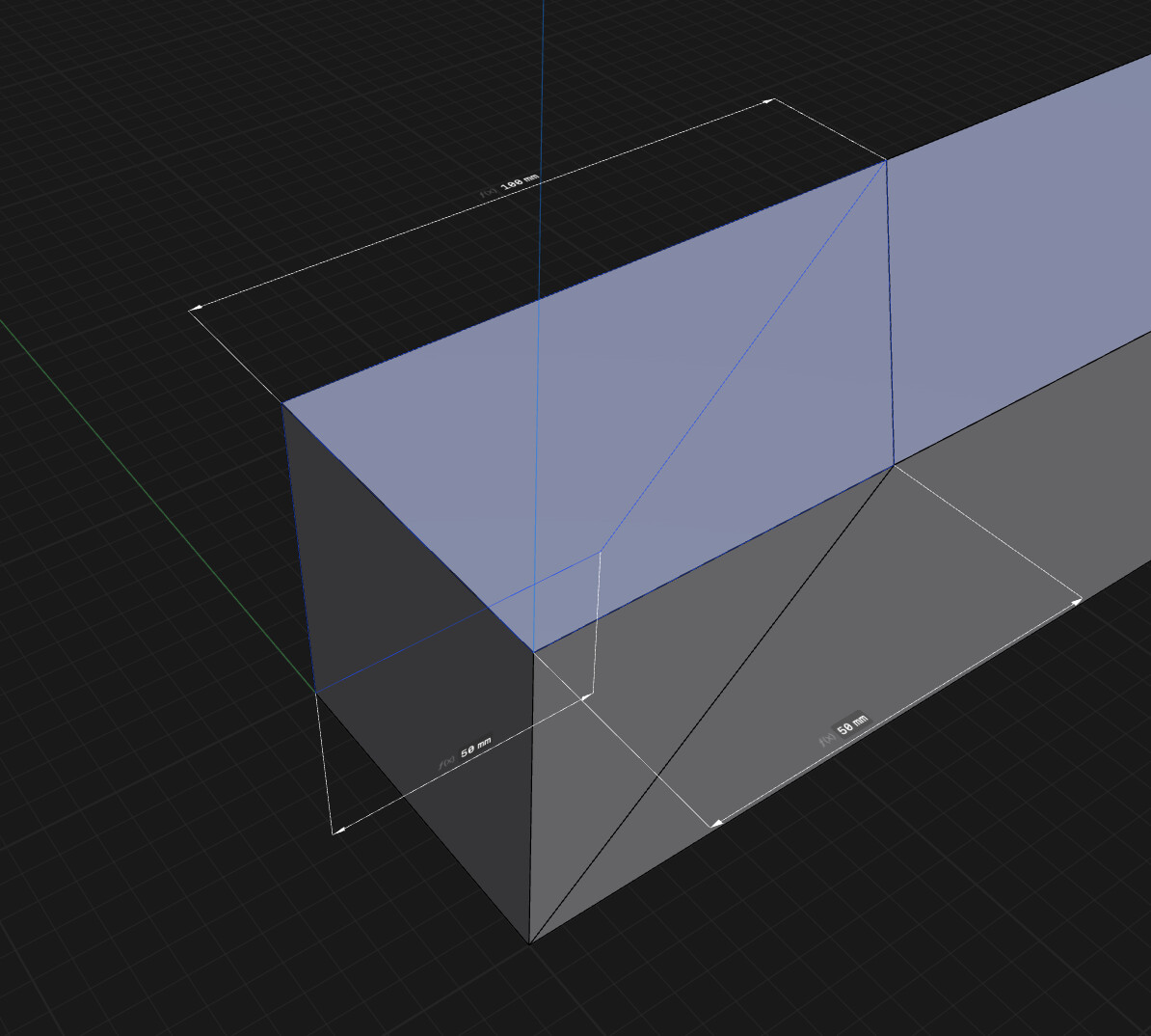

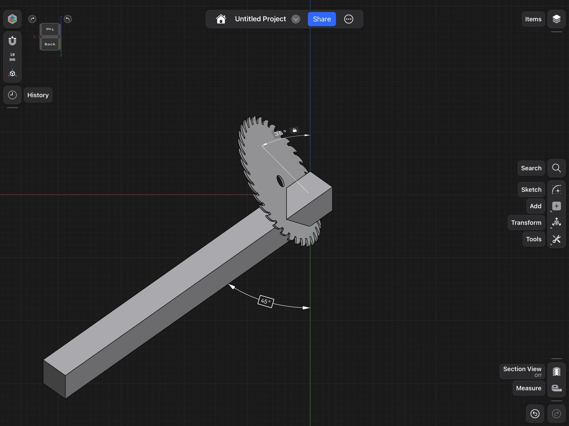

In case you want to do marking before the cut.
So, if the beam is 50x50 mm, we need to mark two “circles” (so to speak — since it’s a square beam): the first one at 50 mm from the end, and the second one at 2×50 mm, which is 100 mm from the end. These circles don’t necessarily need to be drawn — they’re just to help visualize where the cut lines will pass.
Once we’ve marked or imagined those two “circles”, we need to draw diagonal lines. On two adjacent sides of the beam, draw a 45-degree line from the edge to the 50 mm point. On the other two sides, draw lines from the 50 mm point to the 100 mm point.
The actual cut should follow these angled lines.

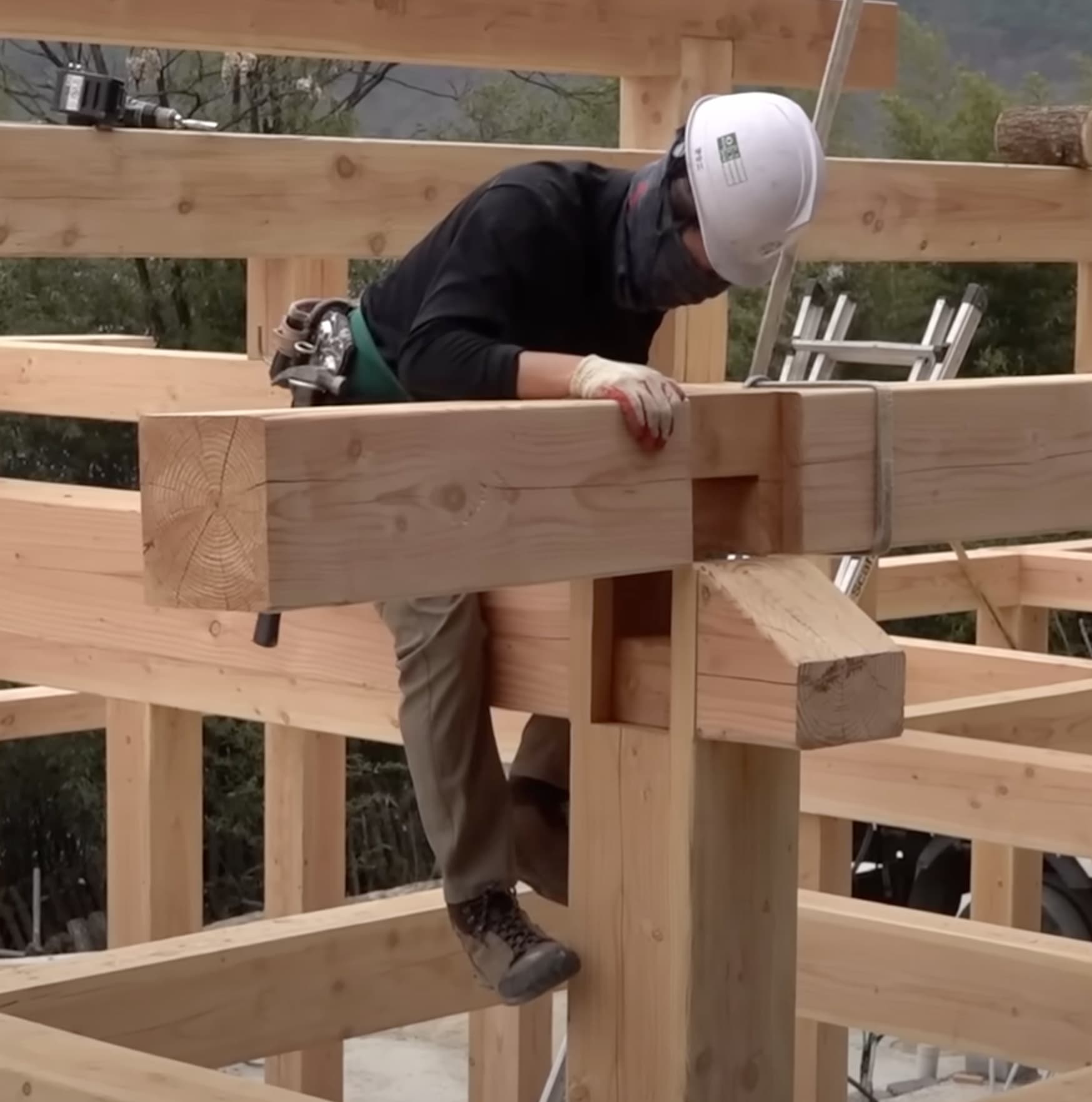

Since my limited knowledge in woodworking is more skewed towards architectural/carpentry.
I see the Wayfair video, it was fitted and held in place by gravity.
You might find this asian style carpentry video either Horrifying or Entertaining.
So, beams are my thing. I can literally school you here. In 8 months I went from temp agency worker to foreman at a glue-lam beam plant. Finding people who can read blueprints correctly… That in between 20 years of construction.
IMO The cross section area at the joint is significantly larger and better “engineered” here. Notice the tension zone of the cantilevered end is put on the top. The undisturbed wood grain at the top will flex better without splitting the beam so easily on the downward force. And flex it must. The way it is supported by the vertical post also helps. And In this case the load will always be relatively constant.

On the Japanese construction, If you move the post to the end of the cant and put a significant load over the the cut joint, the beam has a greater chance to split there. One or two of the Wayfair leg’s cuts for the joint will have inverted cantilevers and they are the weak points in this design.
