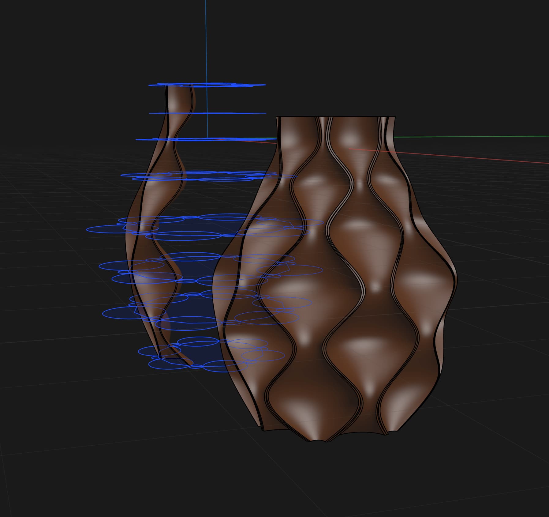

I thought I’d dabble and see what I can come up with. Note that S3D simply cannot model that vase the same way or similar to Solidworks however with some latitude one can make some interesting shapes. My version was done rather quickly and it does not equal the original vase but it is close however incomplete. I had a bit of fun making this. Note that it was initially created in a 30° segment. I did my usual circular pattern to complete the 12 segments. This was the first time it took minutes to calculate the result via the Intersect tool on my M4 iPad Pro, whew!
And here’s the initial 30° segment construct.

Got the original concept working.
I’m impressed how quickly this could be done. Thank you!
That looks pretty close to the original design. Glad I posted this here. Two great but different ways of doing it. Thank you!

This one is another interesting shape. I also tried the tutorial on the other software Ohsape (design up front)! Have to say because they have 3d Sketch this was lot easier, faster to do also more predictable to design, could be faster than Solidworks.

Looks great. I’m trying different things with these circles. Fun to loft them.
