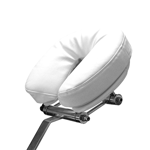

I am trying to create a crescent cushion shape similar to that of a neck pillow. I need to add creasing to mimic the look of fabric. The creasing would go on the innermost part of the crescent.

I’m looking more for something like this where the fabric is wrinkled. Thank you!
