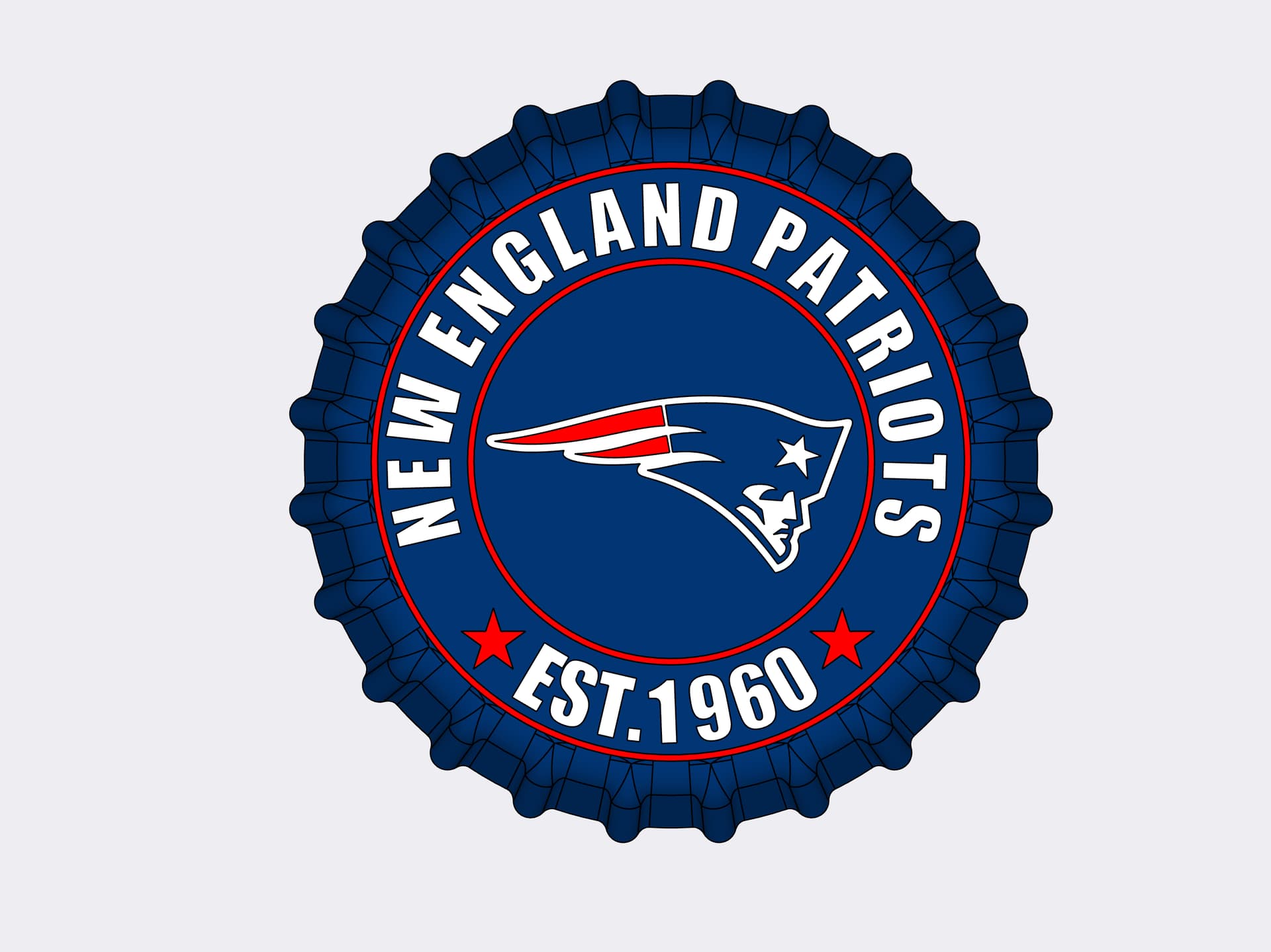

Please add text editing around the circle
I first drew a text vector on the computer CorelDRAW software, and then imported it into Shapr3D to complete the modeling work. It is very much expected that Shapr3D can upgrade the round or curved text editing function based on the current text editing function. This is really very important! Thank your team for your continuous efforts, and I am also convinced that Shapr3D will get better and better.

Hi,Tommy.I have never used this kind of vector graphics software before. The CorelDRAW I Use Is The 2020 Version.
At present, the function I most expect to add in Shapr3D is a round text editing function like pictures, that is, upgrading the existing text function. There is no need to rotate it slowly, or edit it in other software before importing it into Shapr3D for use. That’s too inconvenient! Too inhumane. We look forward to the early addition of such text editing functions by the Shapr3D team. Thank you again for your continuous efforts!
I am looking forward to receiving a reply from the Shapr3D team! Thank you again!

Thank you for your reply. I’m sorry to hear that. This means that similar text modeling and design can’t be completed in one step from text editing to modeling in Shapr3D after importing with the help of other software. This will undoubtedly weaken Shapr3D’s competitive advantage in modeling software. I like your software unparalleledly and look forward to its perfection.
Hi Stephen. I know Corel Draw, and I usually use it to edit similar round text. But that means that you can’t complete this kind of text work directly in one step in the iPad. Shapr3D’s text editing function has been discounted.
