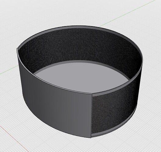

Running opening over night on M2 resulted in this, so it is doable. But not fun to edit as any change takes 10-15 minutes to process.

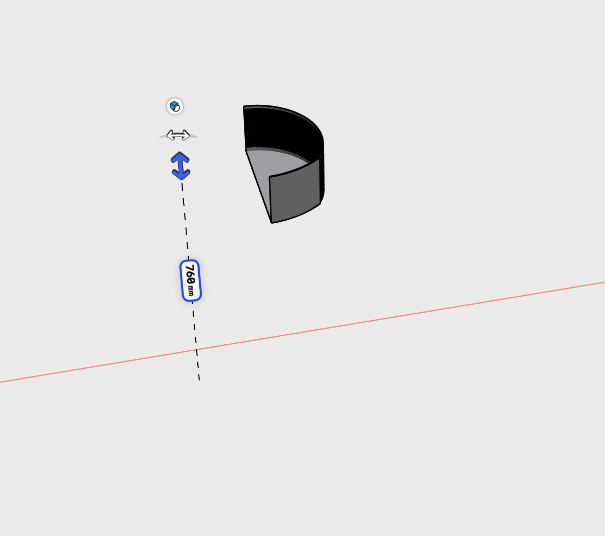

Depends on what editing means, but my general performance test is just simple boolean the object in half.
App behaved sluggishly but did do it in like 2 or 5 mins.

No normal basket will contain this amount of holes.
Unless this is a brutalist building.
Yes, it concur with my observations. But try to move a inner-wall of one of the holes, that is much less enjoyable.
