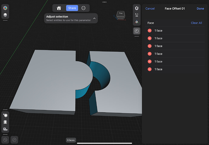

I think that You want to make more clearances between two parts. So whole object got same size but faces in contact with another part has small gap.
There is no such tool yet, but I found this way:
I tried it with this object
1/ So first I put parts apart so i can select faces (you can move with all objects apart)
2/Then i offset all faces in contact by small negative amount (-0,05) this depends on your tolerances
Best way Is to do that on one side and than go to History find that step ( Face Offset) and there Edit… Faces and select all faces on all objects you want).
Click Done
3/ And than, suppress that Movement/Rotation step from 1/ step. So all parts are align again but with proper clearance.
Maybe there is better way, but this seems quite easy.
I hope it helps you
