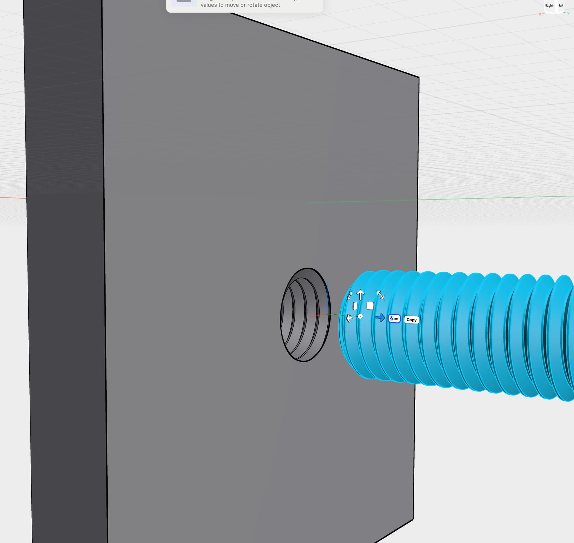

I am having problems with this tool.
The hole for the bolt is much smaller after I print. but even on the drawing it appears so. any guidance??
Visually it might seem smaller because you are comparing with the boolean part.
You can confirm with the section view.
Note the gap on the left and right side, needed that for tolerance for my printer.
