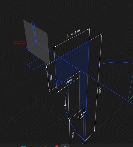

I’m trying to learn shapr3D
shapr3d_export_CookieCutter.shapr (100.1 KB)
in this cookie cutter project I tried to do a SWEEP around a snowman sketch.
It stucks at the hat.
I suppose it is because of the small place between hat and head.
Could someone explain me these limitation that does not allow the to go around this place?
I thought I would scale up the sketch get more place , but the SCALE of the sketch does not work too, because of constraints, but I do not find which constrain is responsible for the SCALE to fail
Thank you for your help
You might try bisecting the snowman and sweeping then mirroring and then adding to work around this.
Sometimes mirroring is helpful that way.
Try bisecting your snowman. Then redraw the profile starting at the bisected hat using a construction plane. It should work. Sometimes where you start an operation like sweep matters.
