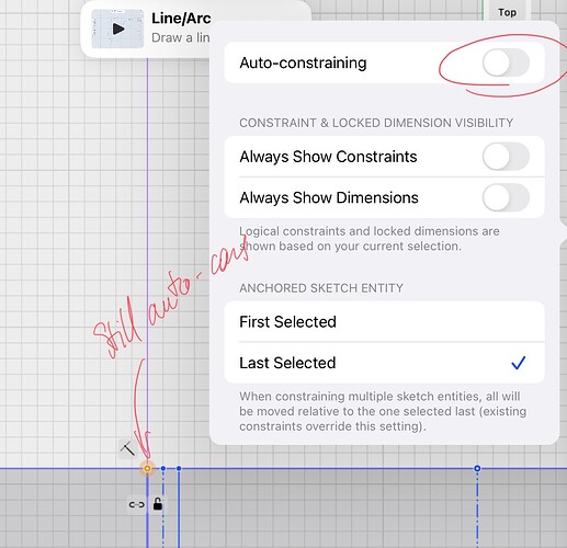

Same issue and it’s very frustrating to have to delete every time auto-constrained points although the option is off. One idea is maybe give a 5sec pop-up panel countdown to accept a constraint.
