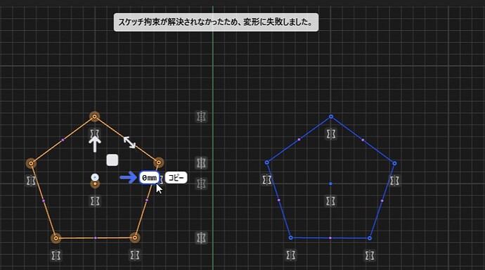

スケッチモードでミラーツールを使った移動および回転ができずに困っています。
スケッチ拘束のため変形に失敗とメッセージが出ます。
これは仕様なのでしょうか?
ちなみに拘束ボタンはグレーアウトしていて何もできません。
移動などができると便利なのですが、教えていただきたいです。

おかげさまで移動だけはできました。しかし回転ができないようです。
添付の画像の上のスケッチは回転はできませんが、下のスケッチはできますので仕様ではないことがわかりました。
It depends on the constraints you applied to the sketch. Sometimes it’s easier to make a copy during rotate and delete old one.
Thank you. Even after copying, I wasn’t able to rotate or move it in move mode. I’ve decided to give up and start over from scratch. I wanted to make a cat. Thanks to you, I feel more relaxed now. It’s 11 p.m. here in Japan, and I think I’ll be able to sleep well. I hope you have a great weekend.

Thank you so much. After watching the video, I noticed that all of your handles were purple. In my case, there were some green ones mixed in. I thought that might be the issue, so I fiddled with it a bit and turned them all purple (as shown in the image), and then I was able to both rotate and move the sketch!
(It seems that first-time users can’t post videos—sorry about that.)
I also matched the constraint settings to yours. I think the settings might have been different when I first created the sketch.

That’s right. Green means they constrained enough to be locked in place.
