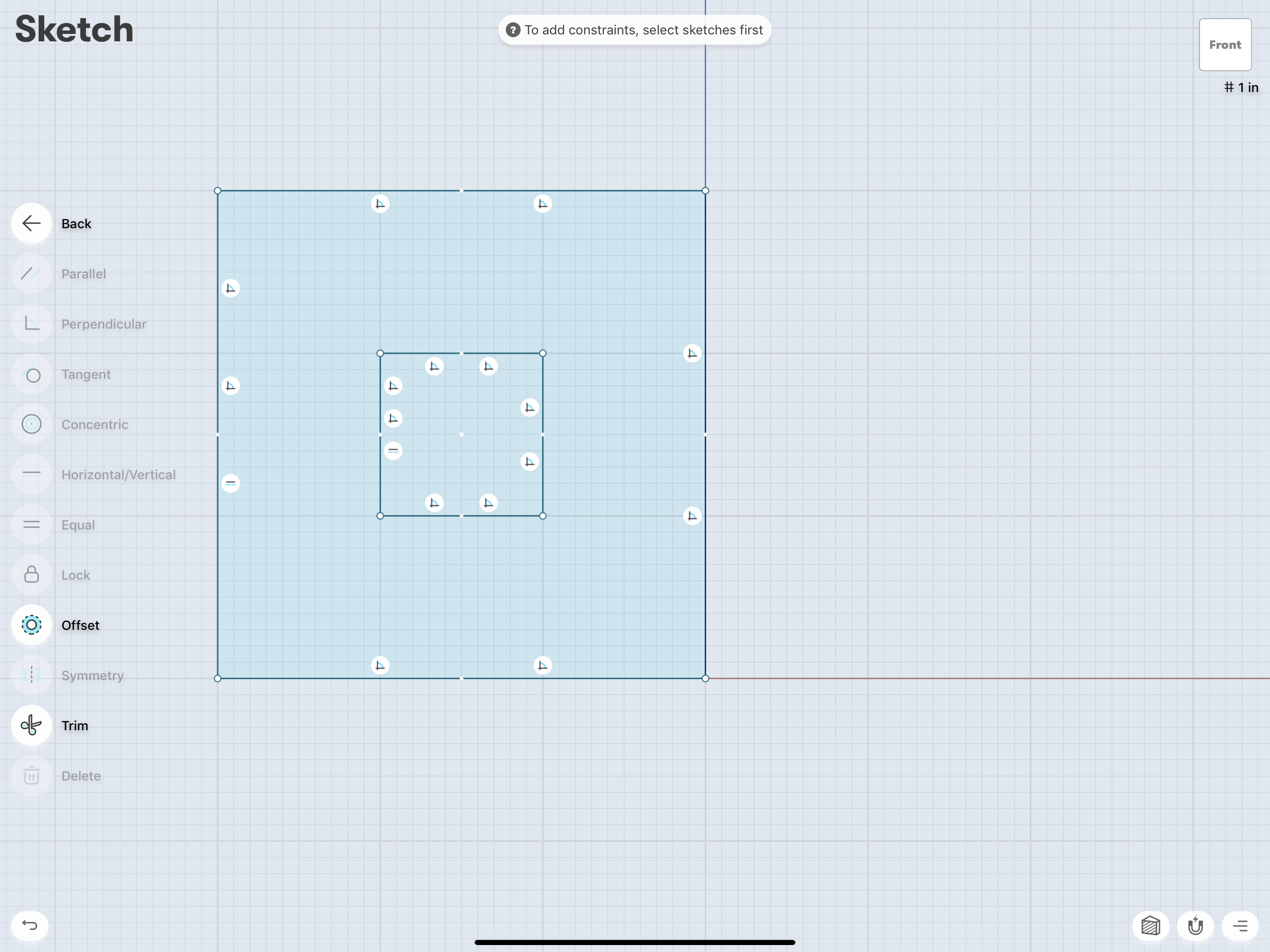

This seems very simple. The small square was off to the right and outside the large square. I X’d the small square and moved and snapped it to the center of the large square. You can then trim out the X.

image Thanks, I’m not sure I understand the X on the inside square in your drawing but I did manage to move and center a smaller square in a larger square - but only by drawing in 1” incrementents and by selecting the outside edge of the square and having it snap to grid, but I didn’t see any centering guidelines … I have guides switched ON yet nothing but the grid’s rounding snaps this example to center. What if my squares are fractions of an inch? Do centering guides then appear?
The X defines the center, even if it were a rectangle.
Understood…after drawing a few Xs and moving them around with other elements the environment, I’ve quickly taken note how much my fundamentals in geometry have lagged & become lazy working with other applications up till now.
I suppose it takes 2 seconds to draw these marks. Thanks.
