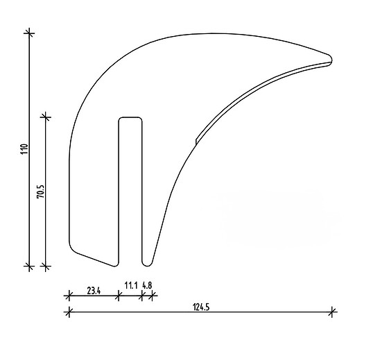

Hi there,
I am designing / printing spare parts for my table saw where specific parts are not available anymore.
In this case, I would like to generate a 3D for either milling or printing a master.
I only have the 2D sketch in JPEG. Is there any chance to do it in a quick fix. Sure, this example is quite easy to do by myself, but I have some others where It would be more difficult.
Thanks, Frank

Make a sketch, constraint every part, set sizes from the photo.
The “solution” is the same as in any other CAD
I assume this is a riving knife and you are designing it to mill it not 3d print it :sweat_smile:
Yes, it is. But I would like to do an assembly trial with a 3D printed sample (no operation of the saw), before I order the actual metal part.
I heard in the past, that pictures can be transferred into vectorized pictures and then added into 3D. Will look into that more.
Thanks to all so far.
You can trace it in Inkscape, for example, but that won’t give you accurate sizes and shapes. Fixing the drawing after Inkscape will take much longer than just doing the work in CAD from the beginning.
