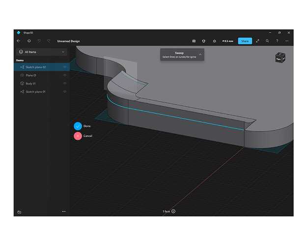

Dear community,
On the edges of a table I want them to go up just a little bit but curvy and smooth. In the middle of the table it should be flat then going further out it should make a slight curve up. But it should be evenly going up on all edges.
Hope this was understandable…
Attached some pictures to describe it
Thank you so much in advance!
SWEEEEEEEP. :grin:
Nice table!

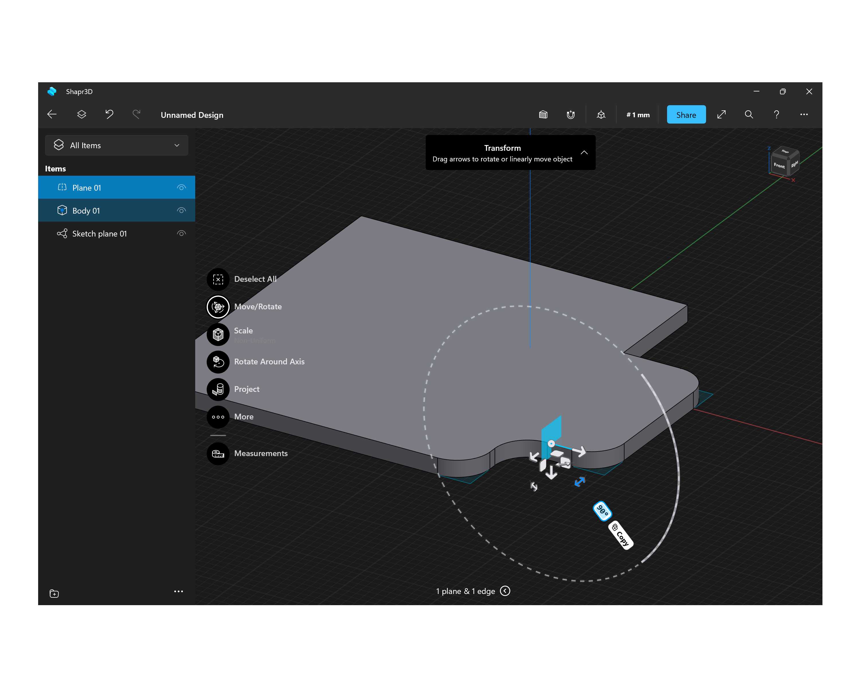

I made a plain to draw on (perpendicular to a point on a line). Rotated it 90. Drew on it and then swept it along the table edge.
So nice! Thank you it worked perfectly
