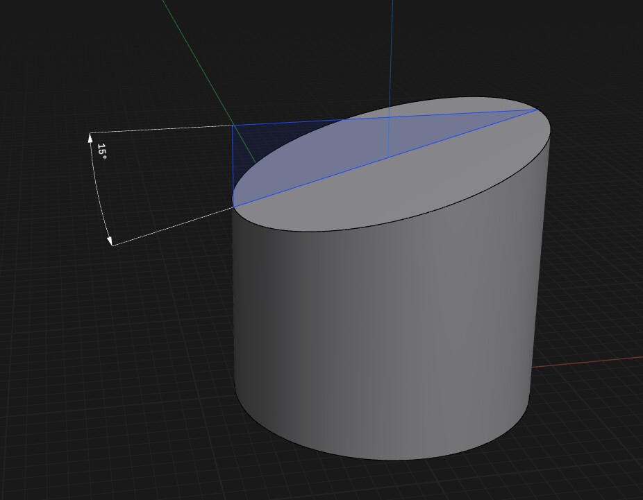

You can select edge and use move/rotate tool. But better way would be to draw a sketch and just subtract top part.

It’s better because it’s parametric and you control everything. I’m trying to use move/rotate tool as less as possible in my work.
Just as an example: try changing the angle to 45 degrees after you’ve already set one. Imagine you’ve forgotten what angle you used the first time.

And here’s the beauty of the parametric approach:
Thank you! Would the split body approach be parametric as well?
In this case - yes.
