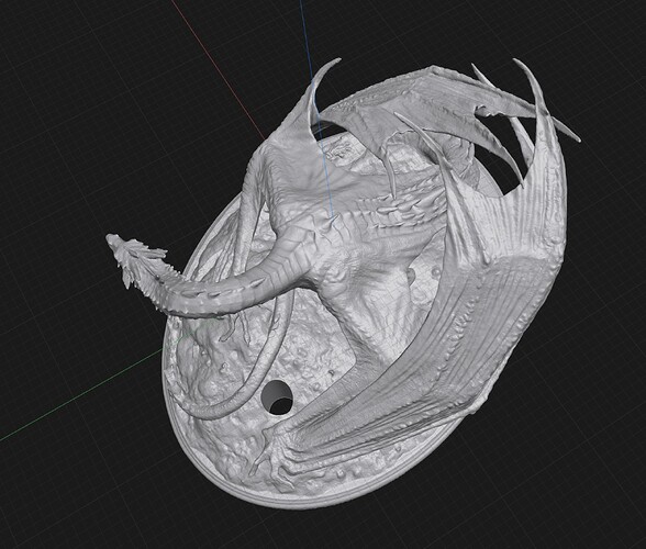

I am having a problem with the subtraction Boolean failed and I don’t know why. Also the Apple Pencil not connected pop up is in the way of the video won’t play. This piece was scanned and now want to fix the imperfections
I am very sure that Shapr3d isn’t very good for your application. You could of course remodel your part based on the scan, but working with mesh data isn’t really possible, at least if you have .3mf or.stl file. What type of file is it?
Make sure your 3d Scan doesn’t have any holes, or you will need to repair it.
You can do simple booleans to a Mesh as long as its solid.
You can repair using software like MeshLabs.
This STL is solid, so I was able to a punch a hole with Shapr.
