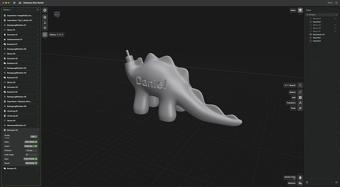

Here you can see the body and the font I want to subtract from the body.

Is this maybe a problem with my Shapr3D file? I changed something in the main body…
Here is a link with my Shapr3D file: Unique Download Link | WeTransfer
Hmm interesting, this might be iPad font bug? Like you said n and e can’t not subtract. I replaced it with exactly the same font on the Mac and it boolean correctly.
I see the problem on a Mac also with downloaded project.
What I’ve done: make extrusion deeper -10 mm instead of -7 mm. But moved sketch itself 3mm away. And everything worked ok

Here is the video from iPad. It’s working the same on a Mac. (I’ve used the file in its initial state after download from your link)

Oh crazy! Never saw these settings, thank you so much! I could replicate it and printed it today, looks great! :blush:
