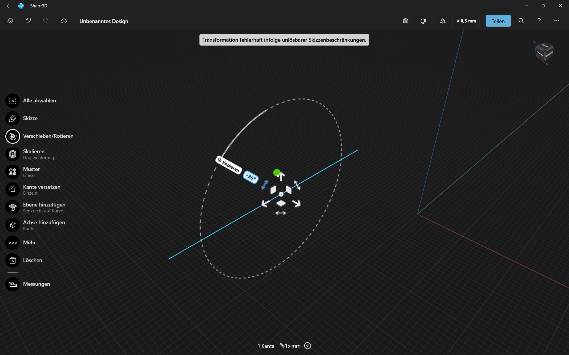

I want to upload a small video because of an error, but I can’t because I’m a new user.

Hi, It appears that the deleted button isn’t updating correctly on Windows. Thanks for bringing this to our attention and we will fix this in the near future. For the time being if you want to delete constraints ensure the delete button shows ‘Delete Constraints’. The best way to ensure this will happen is to make sure you have nothing selected (the delete button should be grayed out) before you start selecting constraints. After you select your constraints the delete button should shows ‘Delete Constraints’.
