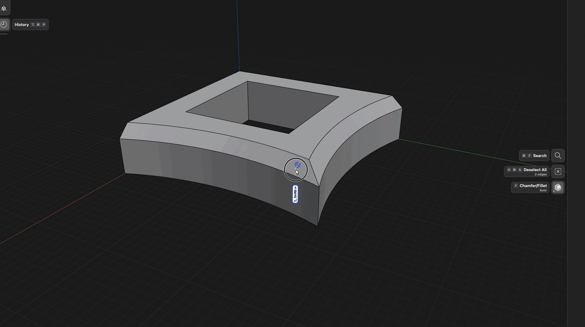

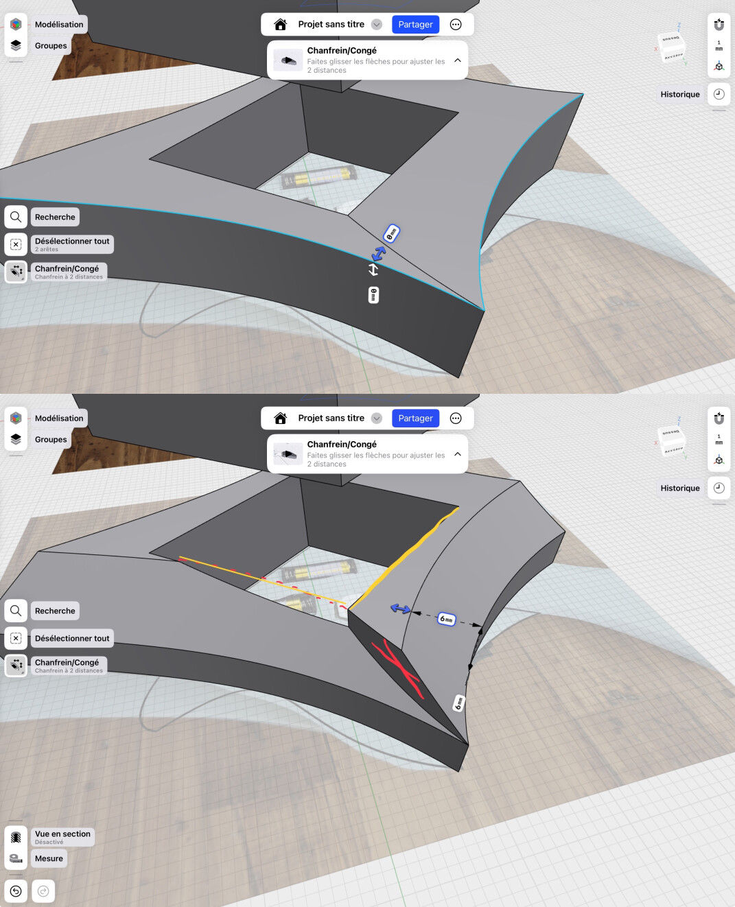

I’m learning but I’m facing something difficult, I would like to make same edge but it don’t work. I need the yellow line to stay, and having the same curve
Can you help me please ?

Looks like the problem is somewhere in your initial object. Hard to say anything without seeing it.
demo
I think the problem they are having is there sketch isn’t symmetrical?
It need to be non symmetrical, I try to recreate this piece first (the rest will be harder :smiling_face_with_tear:)

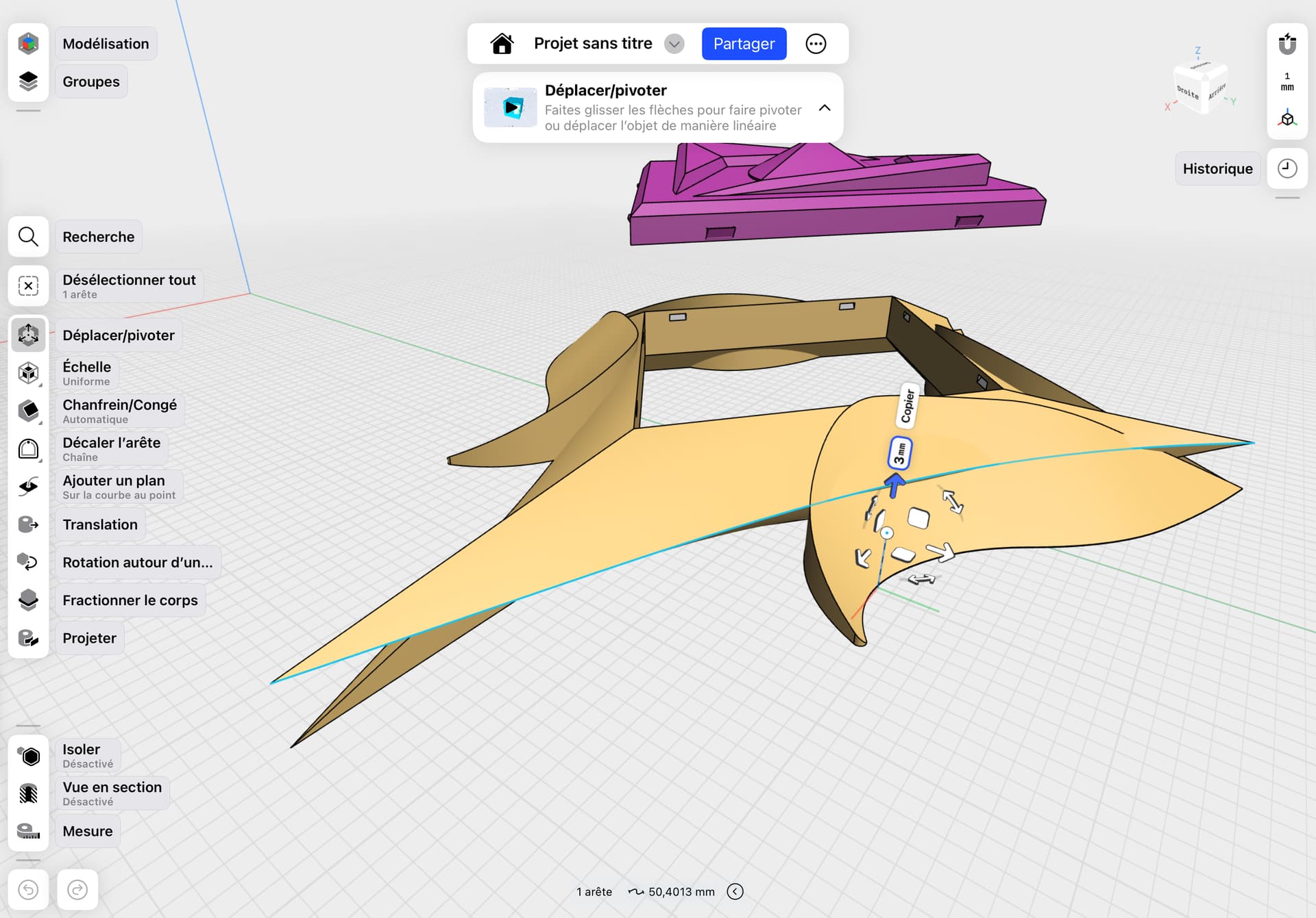

Hi, try to make the chamfer profile sketch and do a sweep using the curve. Subtract the new body with from the original. Here is a video example of what I’am trying to say. Hope it helps, if not, let me know more about it to see if I can help.
https://www.loom.com/share/26bd7c8aba944405b4f2599e26c374d8
Managed to do it with just translating the edge directly up and down
