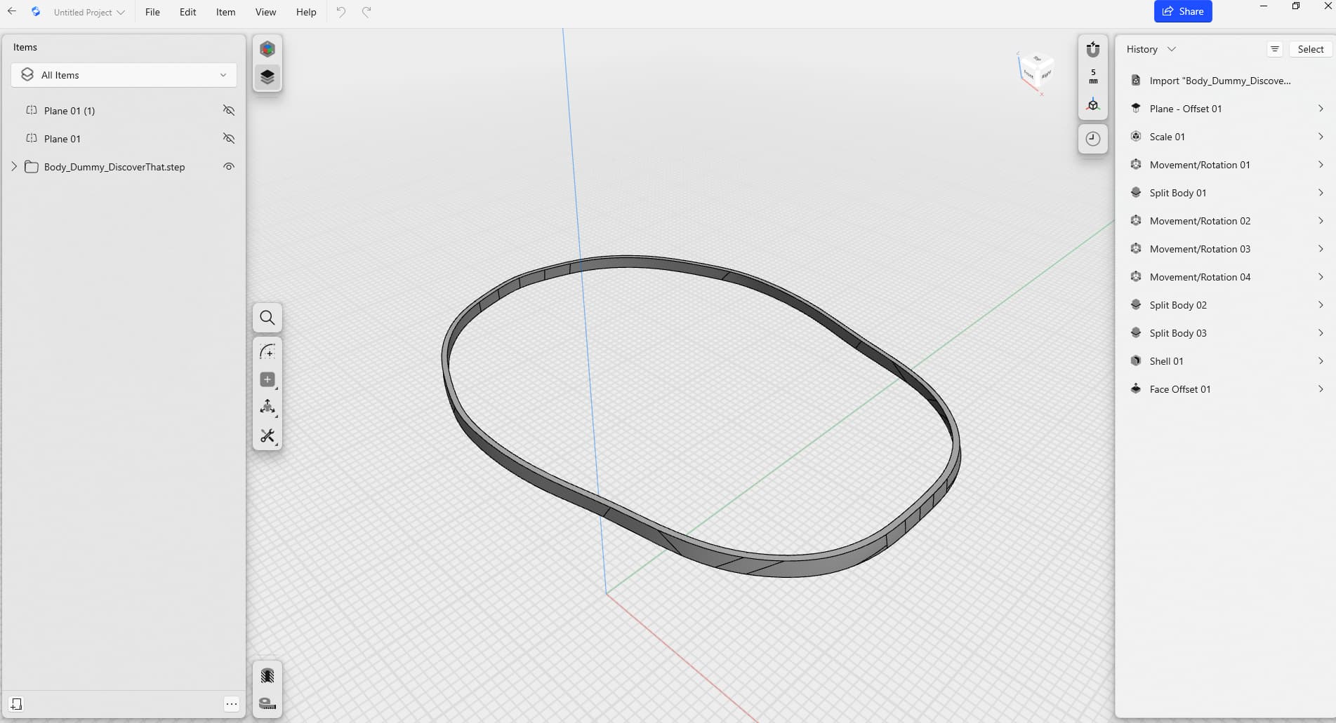

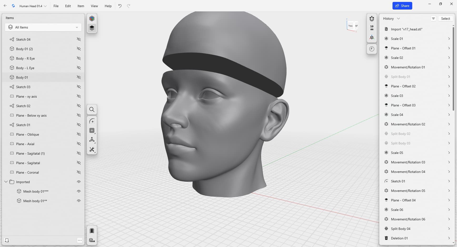

But if you want to hollow it in Shapr I would slice the head multiple pieces (also in half) so you can use the outline to sketch and finally loft, kinda like this.

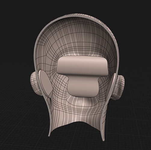

You don’t even need to buy anything. Here is a head in parasolid format.
Generic Human Head.zip (4.8 MB)

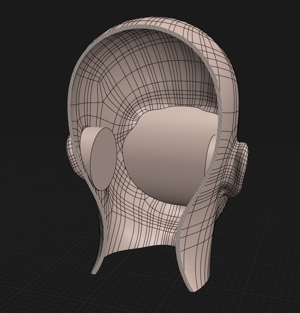

So yo could easily produce something like that
After my mods
Generic Human Head.step.zip (5.8 MB)
Alex! You are indeed a gentleman and a scholar! :slightly_smiling_face:

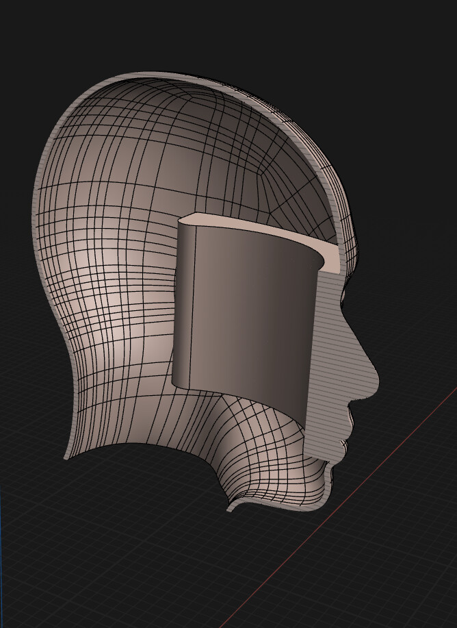

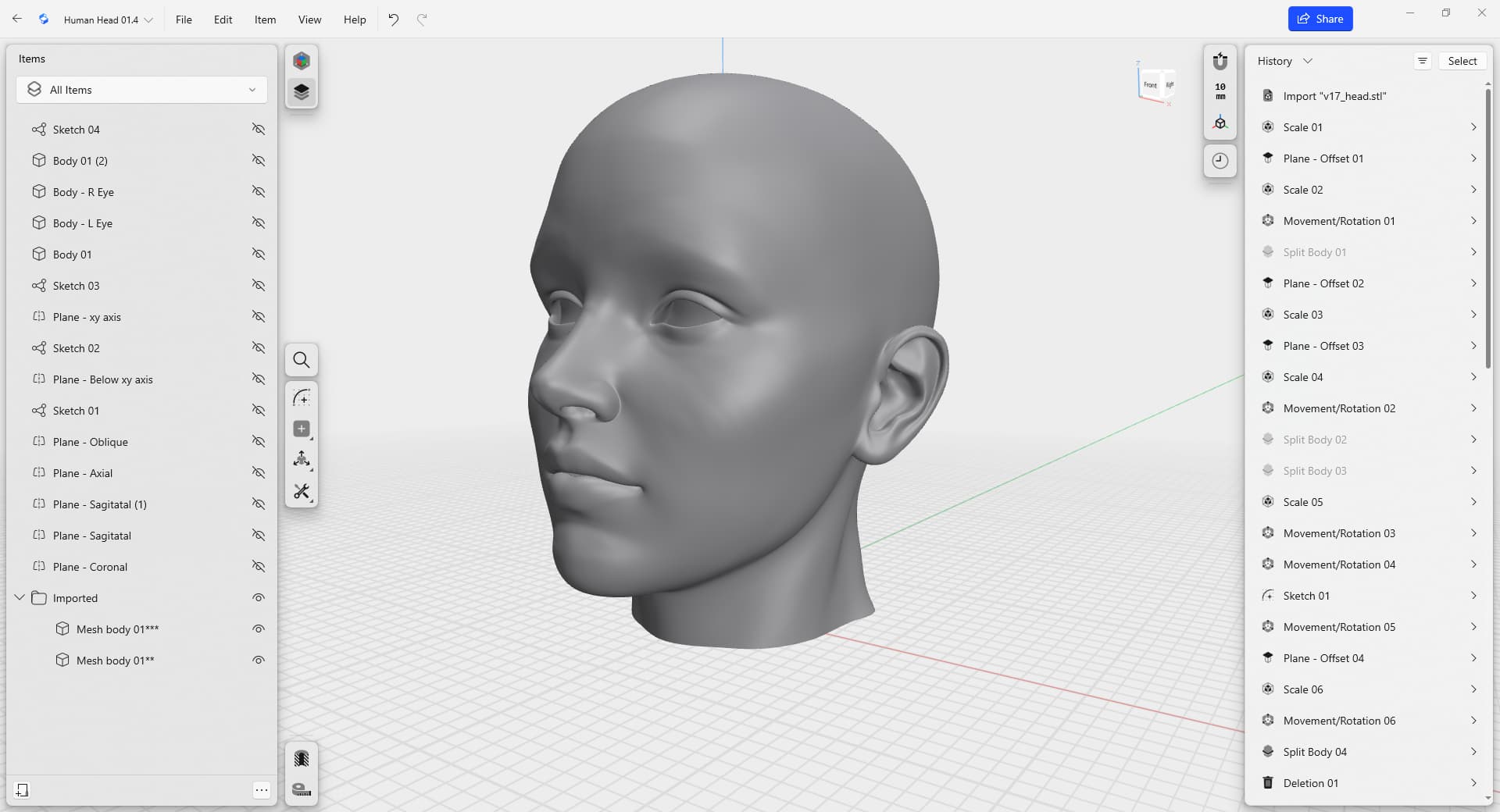

I’ve searched high and low (mainly googling and yegging) and could find anything like this. I am interested in what tools you used to hollow out the solid head. I tried splitting at the neck and using the shell tool, but Shapr3d balked. And I see what you did with adding the addition structure on the face and ears.

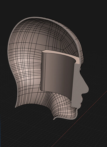

Here a proof of concept. Lot’s more to do, such as creating the mounting mechanism.
Thanks so much!
Mark

Thanks for the tip about splitting into several slices. It tried it on one slice and was actually able to use the shell tool!

I isolate problematic parts and then just used shell tool as usual.
This one I downloaded from https://grabcad.com
Too complex geometry to be shelled in Shapr3D, that’s why I had to add isolation parts.

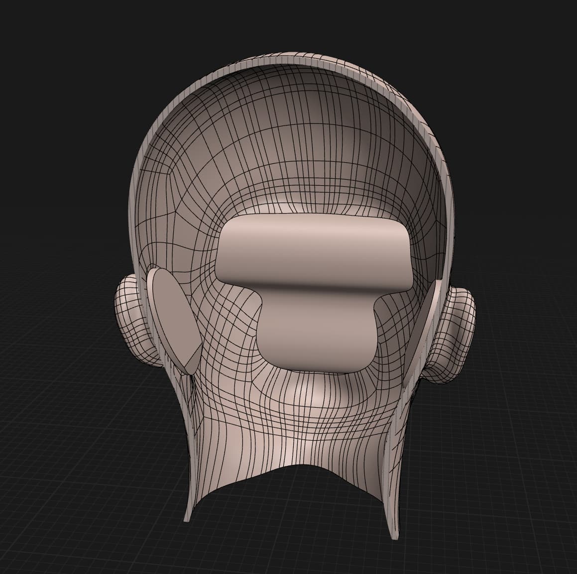

Just a little more space
Generic Human Head.step.zip (6.6 MB)

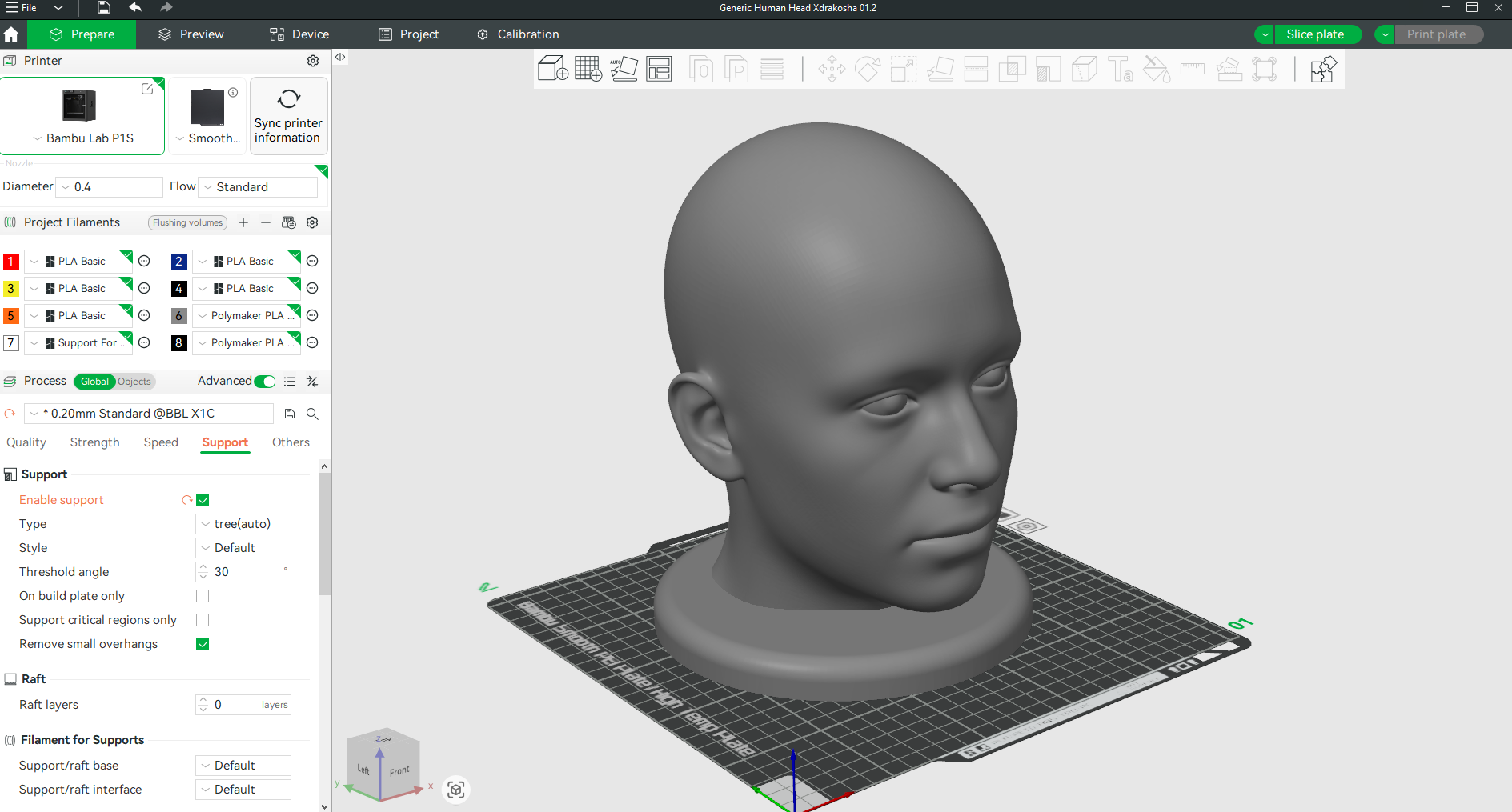

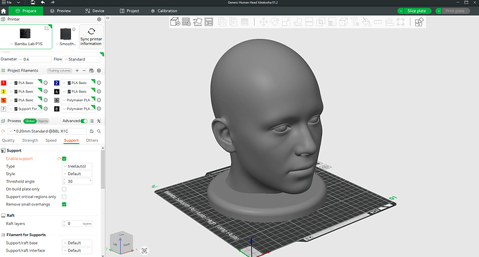

You could take your current model and hollow it in the Slicer.
In the Settings, Wall setting controls the thickness.

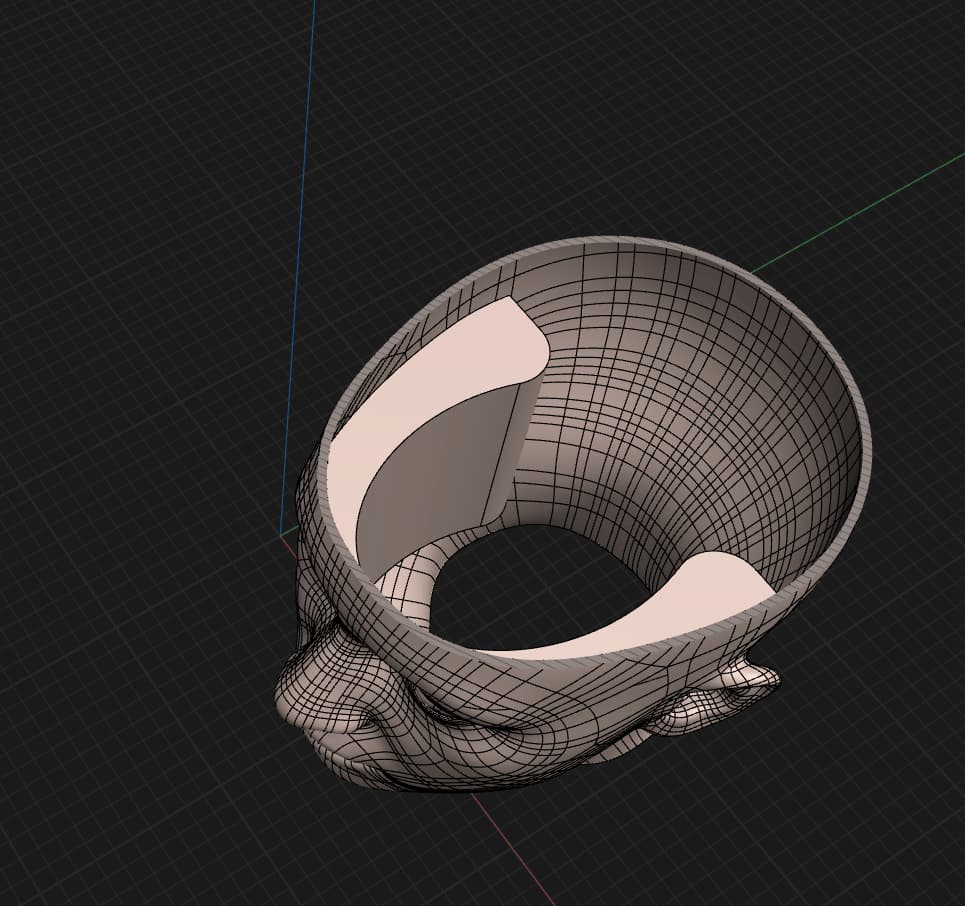

This is the last one.
Generic Human Head.step.zip (6.7 MB)
KYUN,

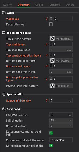

What slicer are you using? I’m using Bambu Studio, and it won’t let me set the following parameters to 0:
Top paint penetration layers
Bottom paint penetration layers

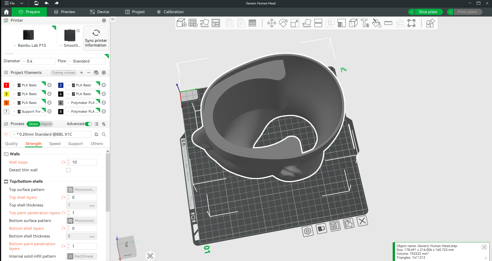

The resulting slice has these solid elements around the front and sides roughly below the eyebrows:
Thanks for point out this function in the slicer!!!
Mark

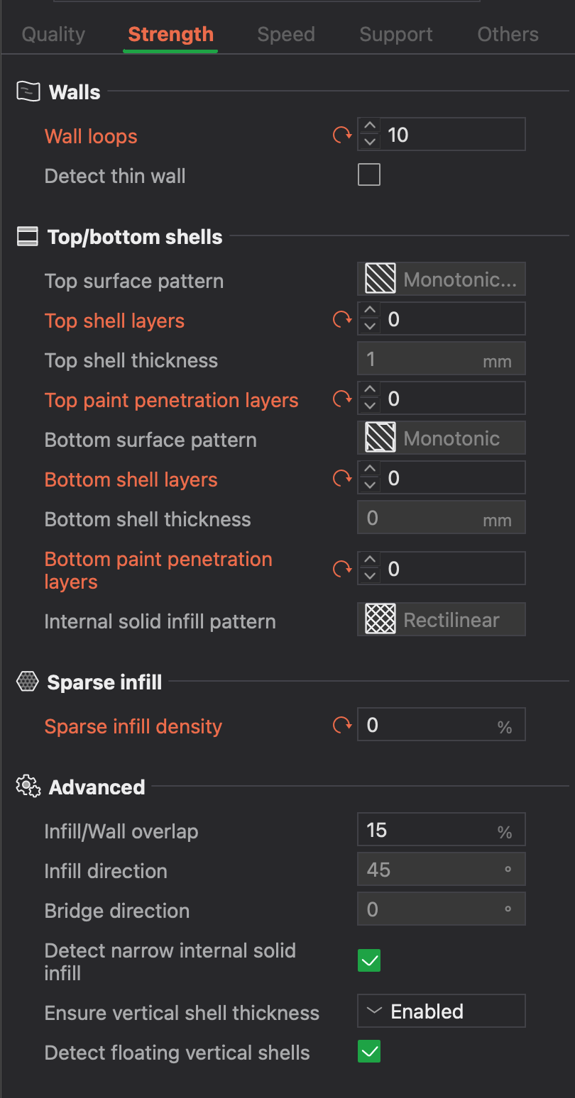

Those 2 can be 1 its ok.

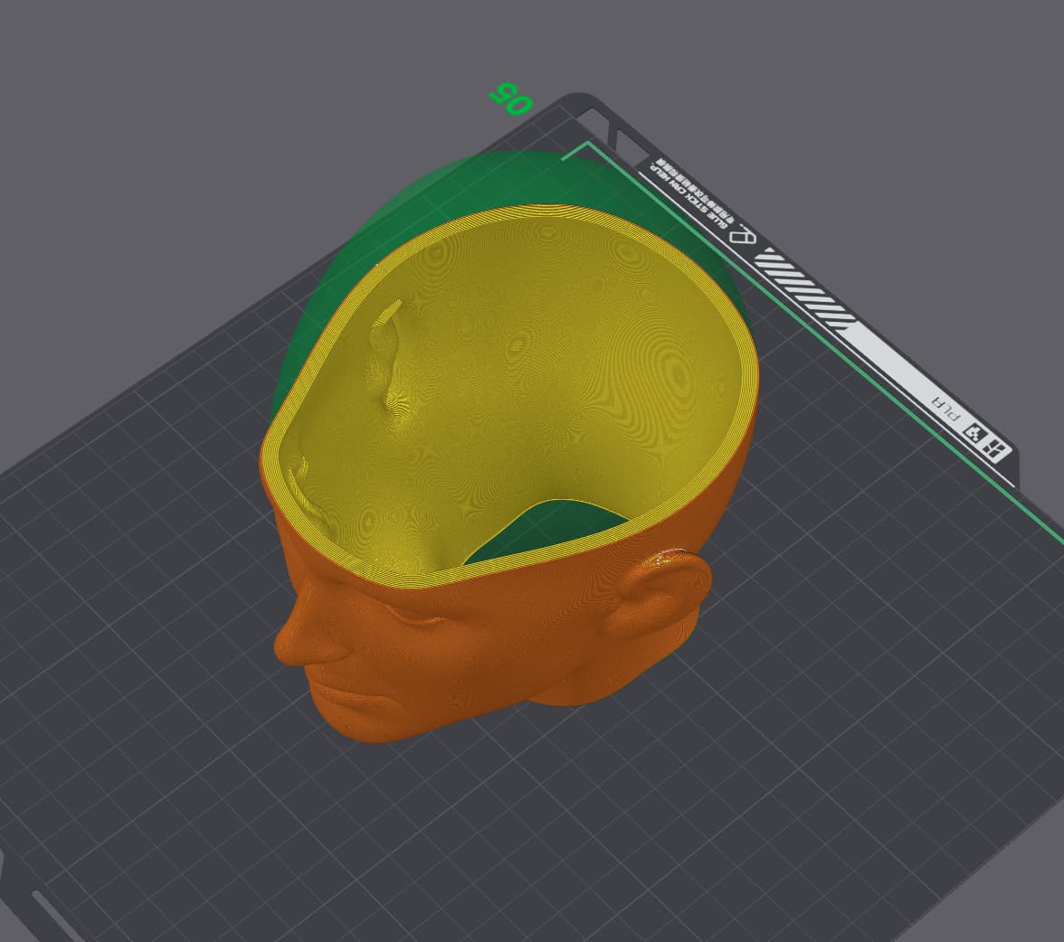

What you want to try is the Wall Loops, if its 10 it’s like creating infill and will be very thick, try starting with 1 first and increase it.
Alex file is already hollowed so you will see how it hollows when you apply 1 Wall Loop, will look like this.
My example, was applied to a SOLID STL, so you can apply the setting to your original STL download and it will create wall loop of 10 with bottom opened. It’s .2mm nozzle so you are thickening it to 2mm with 10 wall loops.

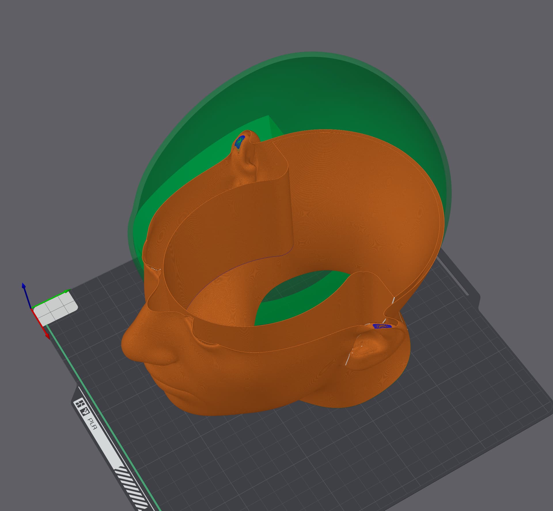

You can export as Gcode and get 3d model out of it.
More on that here:
https://all3dp.com/2/g-code-converter-what-can-be-converted-to-from-g-code/
Also Prusa Slicer can export Slided Toolpath to OBJ.
