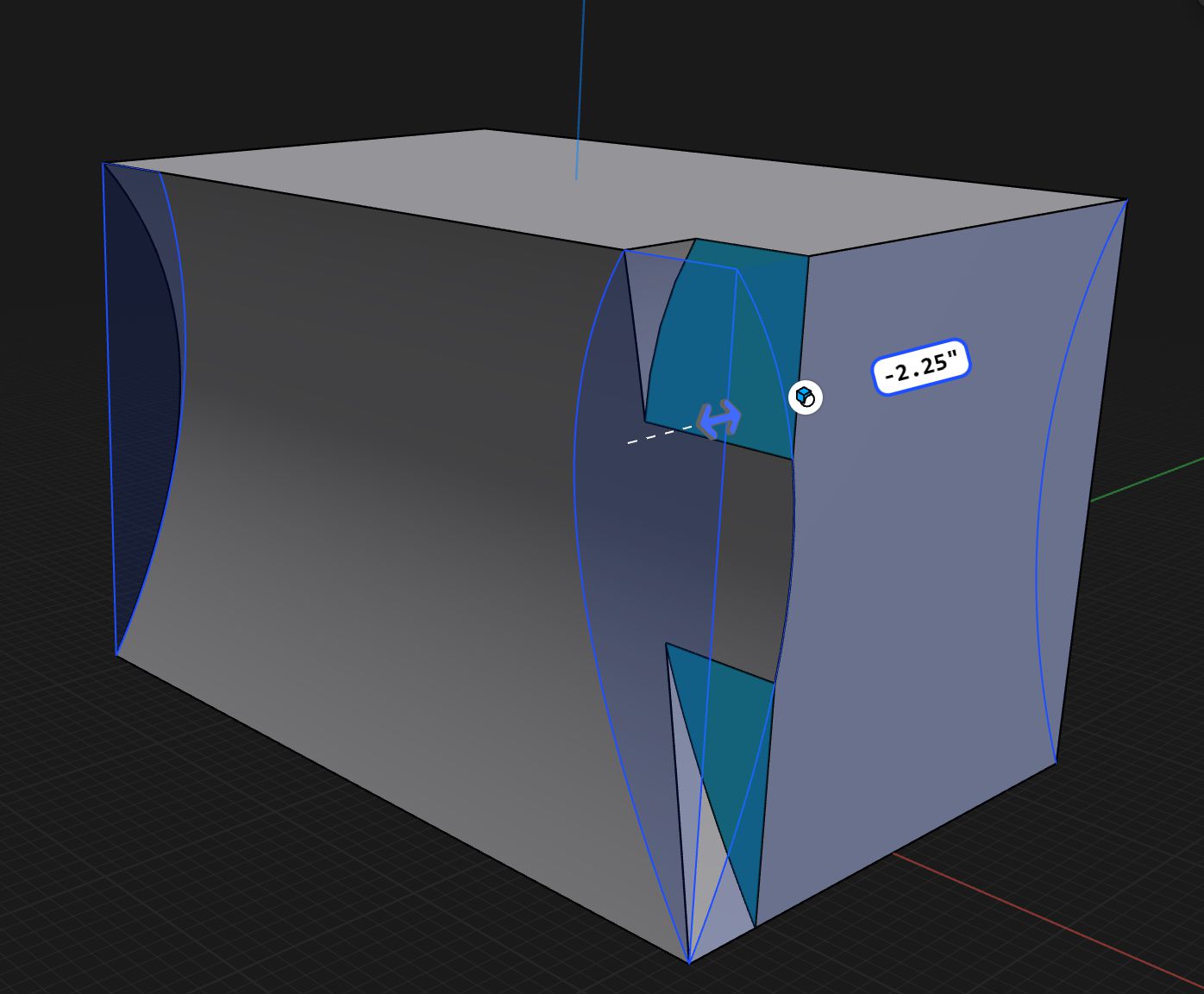

One way is to extrude a rectangle and sketch on 2 sides to select and extrude cuts

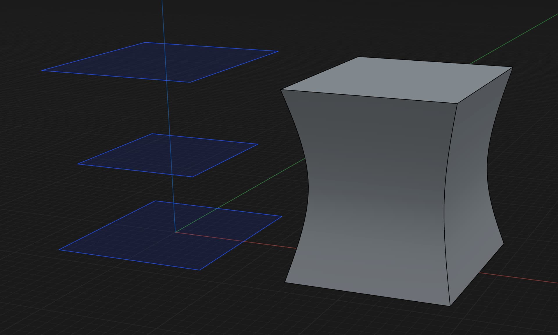

The other way to make the base is sketch 3 rectangles 1 above the other of different sized and use the loft tool
The extrude cut in action.

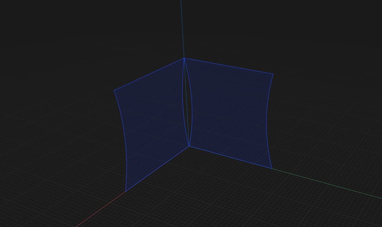

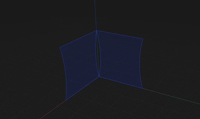

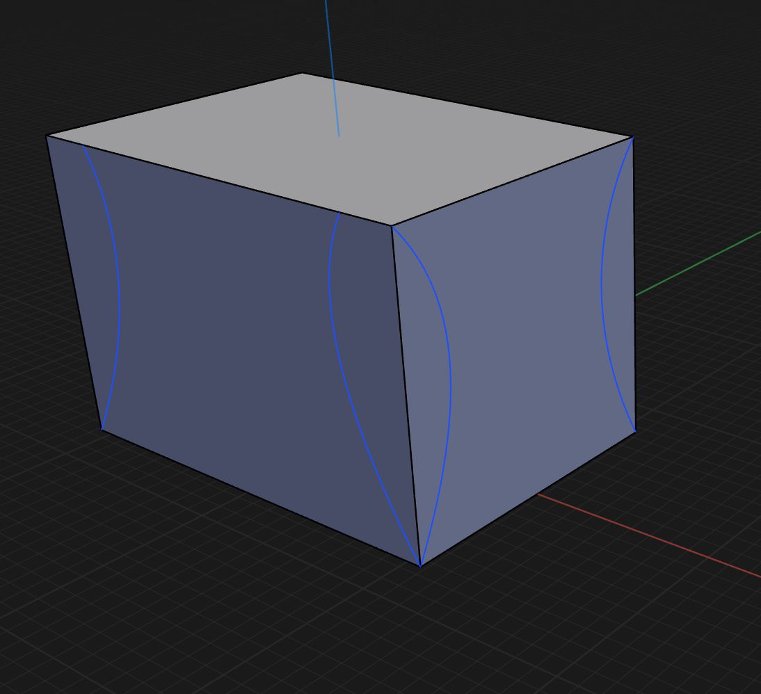

Here is another version if you like to make it bit more harder on yourself.
You can sketch the guide on one of the corner at 45degrees and project with LINK to both side.
Single guide will control all the profiles.
I’d say the shape is so simple that using anything beyond one sketch for the profile and another for trimming the edges from a 90-degree view just doesn’t make sense :slight_smile:
Or just 1 sketch.

We can use Loft without guides.
Oregon covered that one already, 3 layer loft, just adding different methods maybe not the most efficient, but up to the user to choose which one to use.
