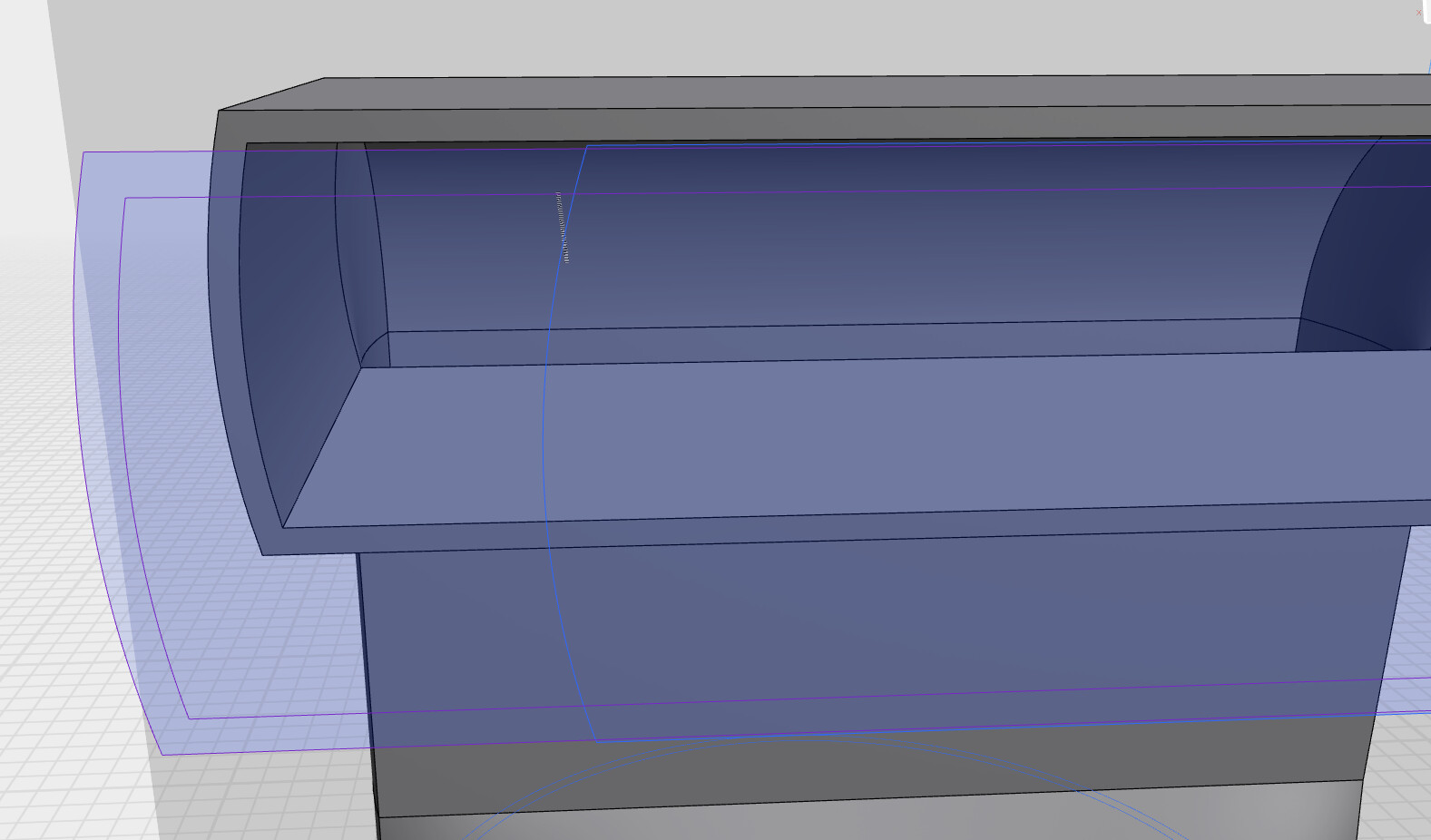

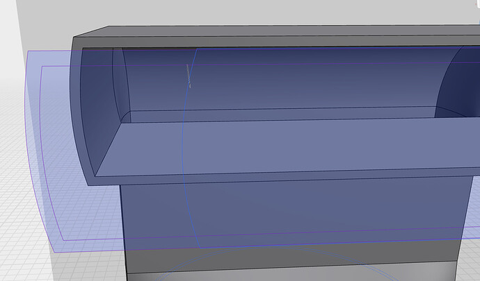

I”m projecting the face onto a new Plane, and then trying to offset the outer edge. It also shows the constraint for the offset, however, when adjusting the size of the inital object, the offset is not following.
Before adjusting the object size:
After adjusting the size:

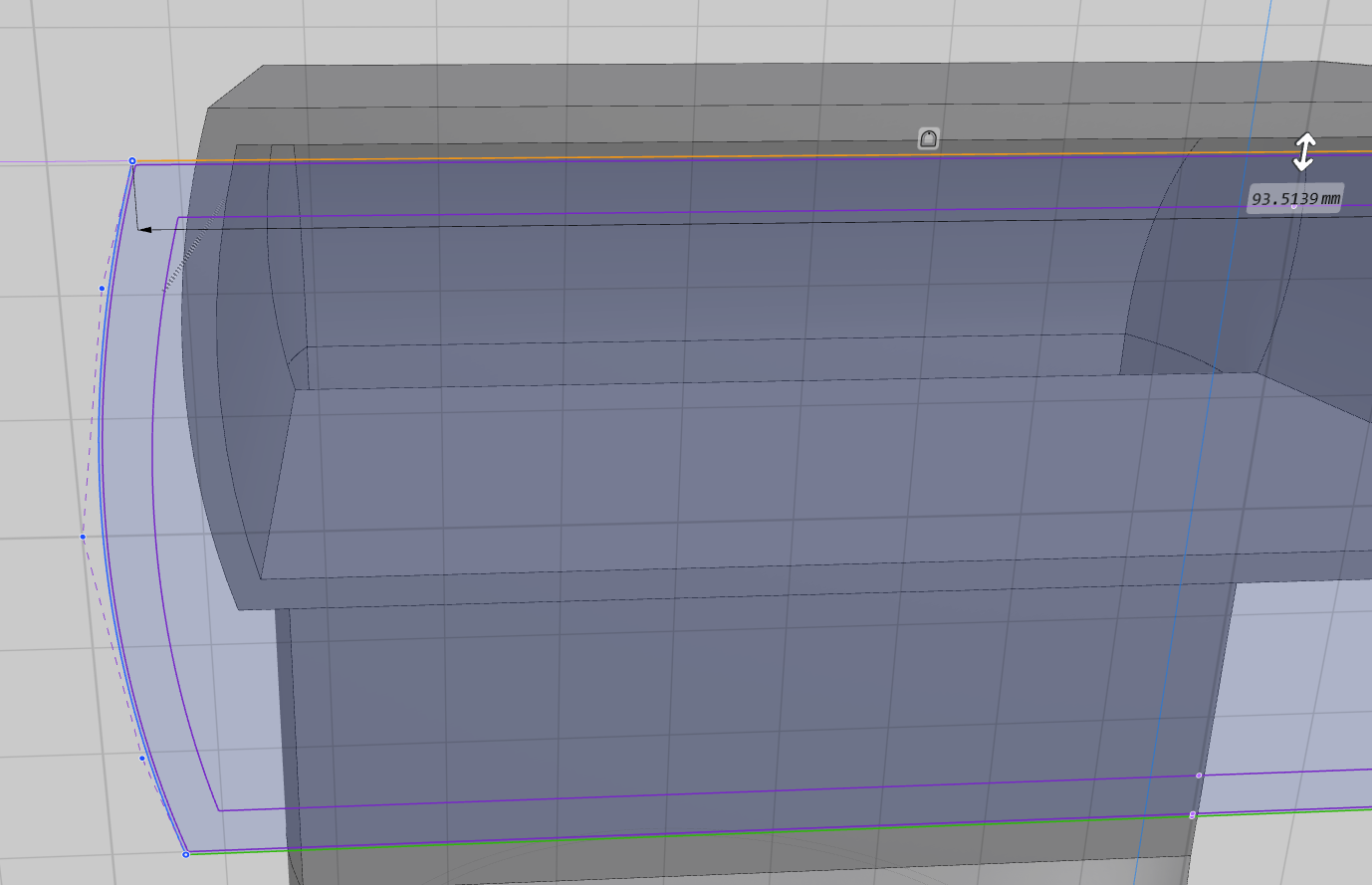

Edit: Created Offset constraints not updating properly .
Looks like that’s because these constraints don’t support splines.
