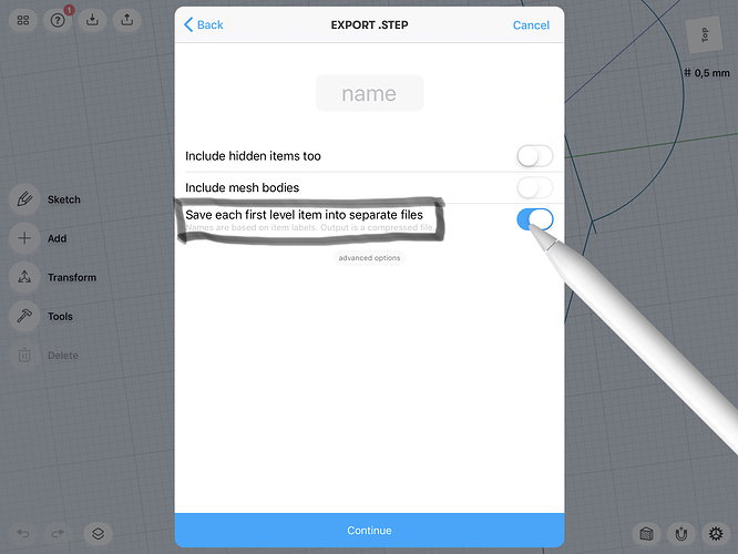

I have some questions is there a way to save shaper file not in a zip folder so I don’t have to download another app to unzip the file before I view it in 2d in another app on my iPad ? But hands down I love Shapr3D I would recommend it to any one!
Hi, I misunderstood your request, I apologize. Turn off the “Save each first level item into a seperate files” in the export window as shown in the attached image. This way the output file is not compressed.
