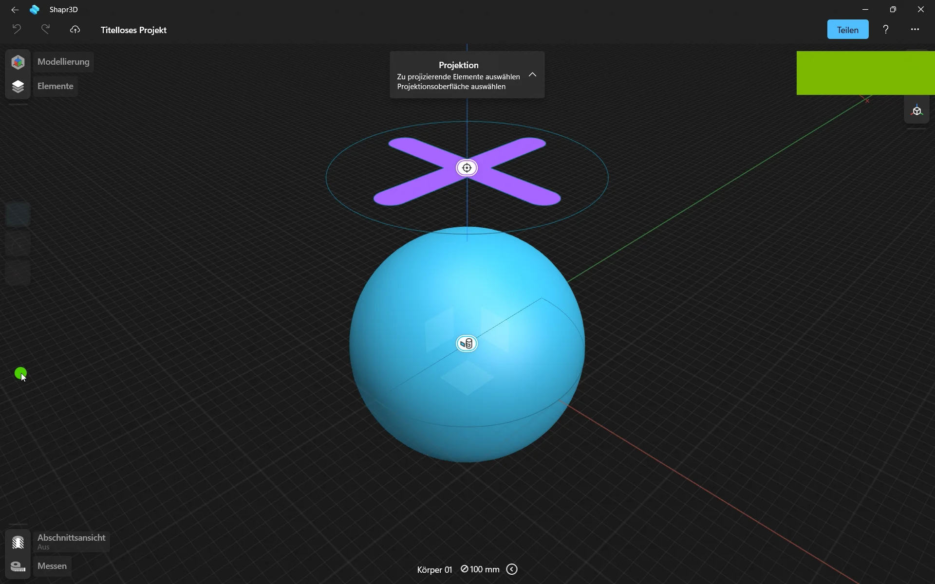

Attached is a video why doesn’t this work in the beta?

Hey - Offset face is no longer the primary tool in case of face selections.
When you operate in the Beta you have the Move/Rotate tool activated, not the Offset Face tool (as in the Live app).
If you want to achieve the same results as in the Live app, please select the Offset Face tool from the tool list (3 tools down)
